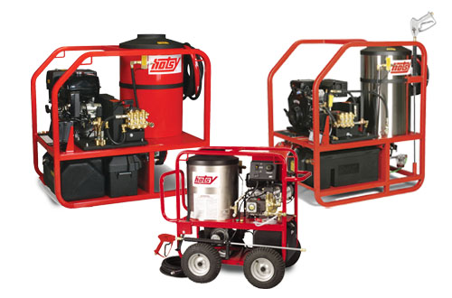

I'd be more concerned about fuel, expense, wear 'n tear, spinning a big blower for nothing and hours on a $100k unit to do the job of a $4-$6000 dollar Hotsy
that don't make cents to me :headscratch:

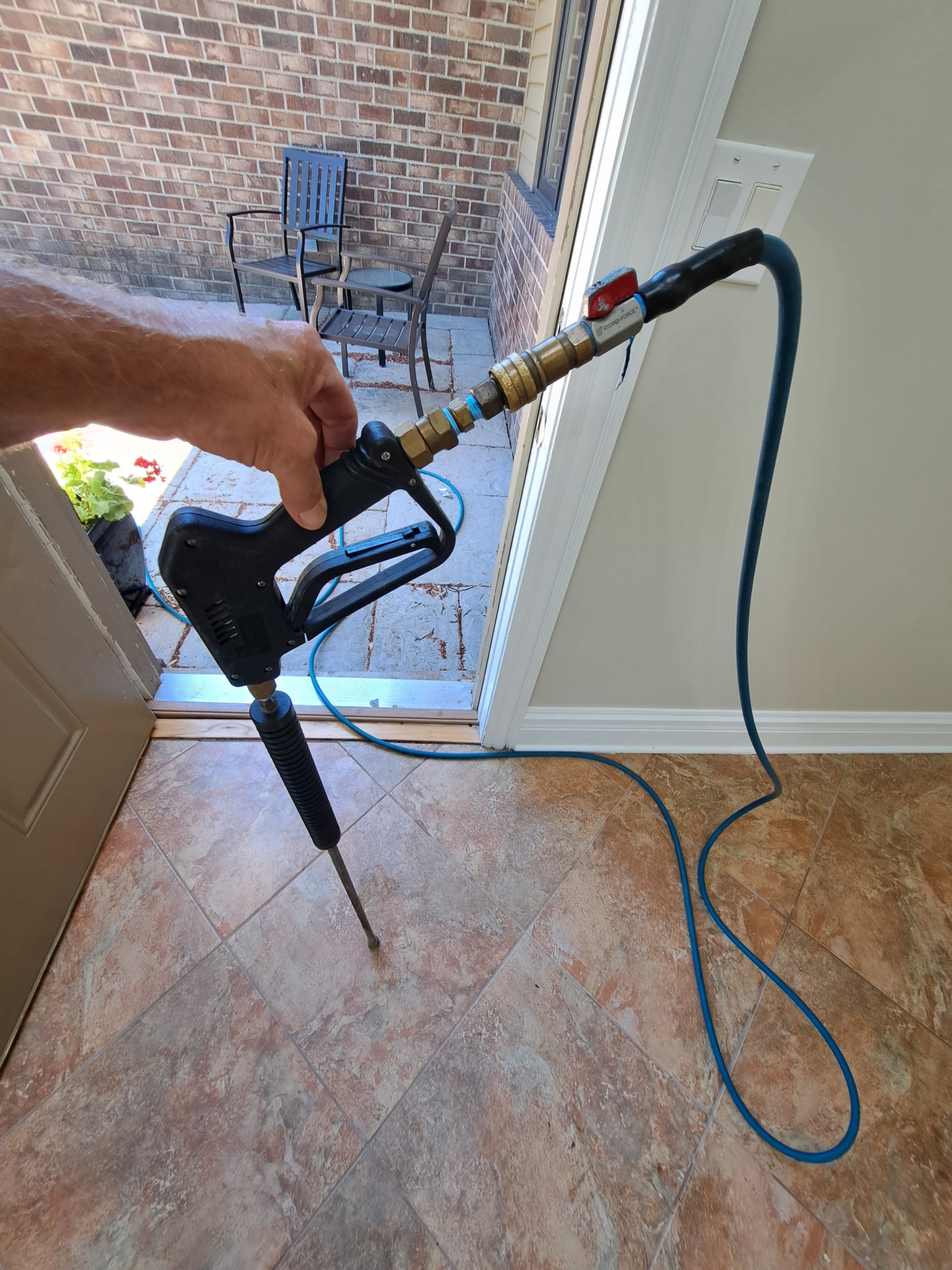

I keep a pressure washing wand on the van.
I clean porches and sidewalks quite a bit.
I use it to clean other tools also like the brush on the floor tool.
