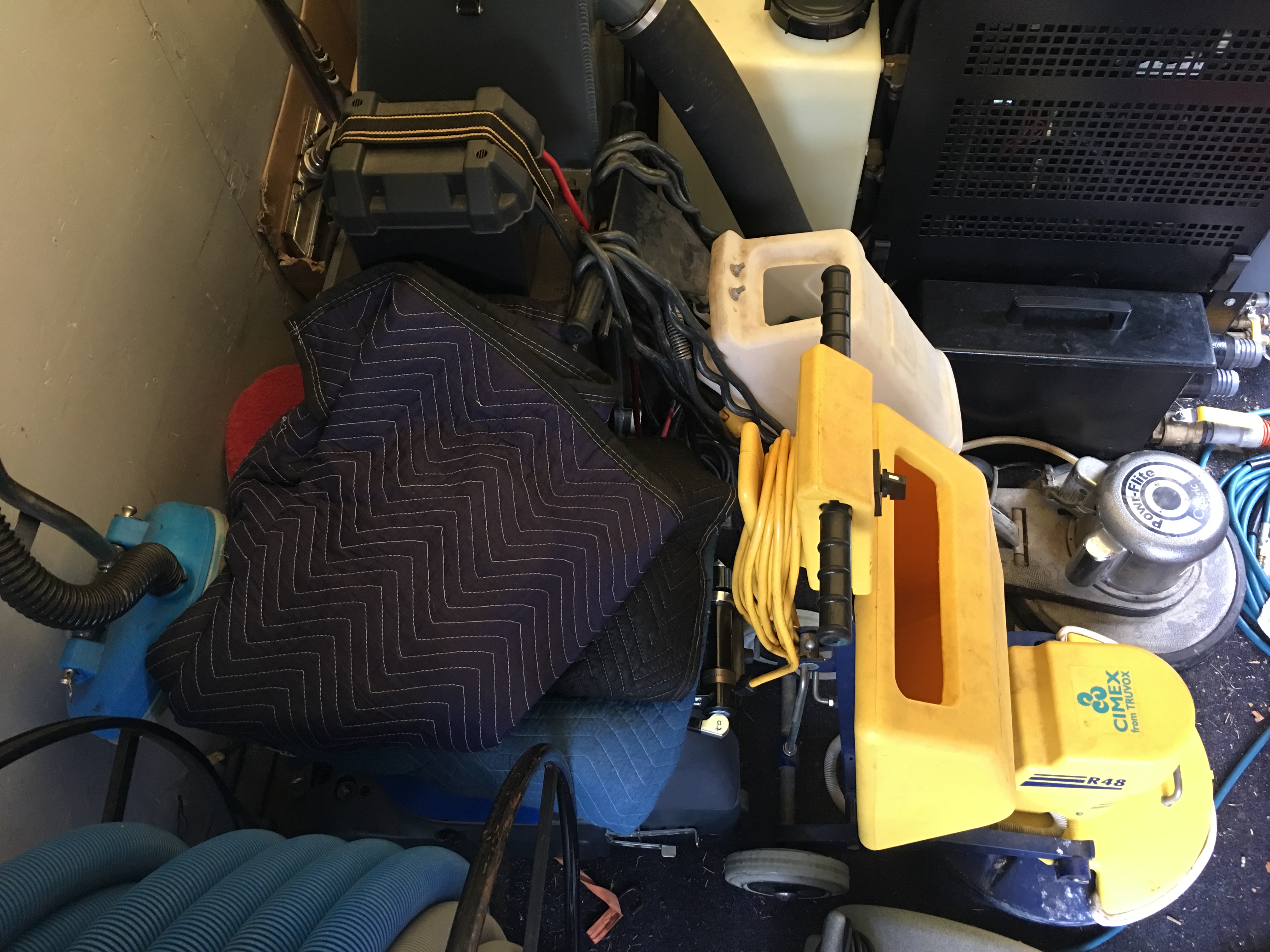

I’d like to squeeze it right where those blankets and cimex are sitting parallel to my truckmount in between the hose reel and waste tank

So after I couldn't find any WM bankrupt tanks, I found what you see above. The hell with paying $2500 for a water tank. Screw that
I wouldn't pay that either, and never have.
That tank is awkward to use, and actually wastes space compared to its capacity. Designed by someone who doesn't clean carpets.
Looks good in an empty van.
