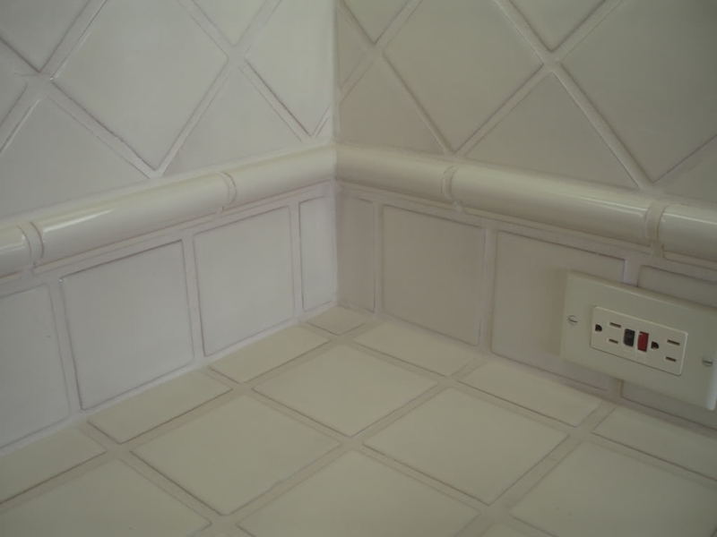

Heres my question,how long before it wears out and looks like a bad caulking job?
116,967
Use neutral cleaners and a sponge and probably never.
at least that's what the sales men tell me.

I like it, that guys from Cleveland I need to hook up and do a ride-along with them and check that stuff out.

I've been using Grout Perfect for 4 years and that job that Mike did will last for a LOOOOOONG time.
If you get the grout clean and there is nothing on it (wax,mop&glow,etc) it will last (don't want to use the word forever) The problem is people don't get the gorut clean or know how to test for problems and try to color seal anyway then your right it comes off and looks like crap.
Nice Job Mike!
