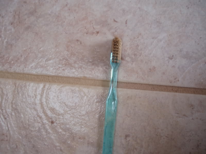

How long do the brushes last before you have to replace them? Do they clean easily? Or do you have to throw them out after every job because of specialty color mixing?
T
TimP
Are you talking about the tooth brush to color seal. You can replace them every time if you like 1-2 bucks for a toothbrush. I think you can afford it making a buck a ft to color seal. Although they do rinse good and you probably could use them again.
A grout scrubbing brush lasts a while although the point on them goes away after a few jobs.
