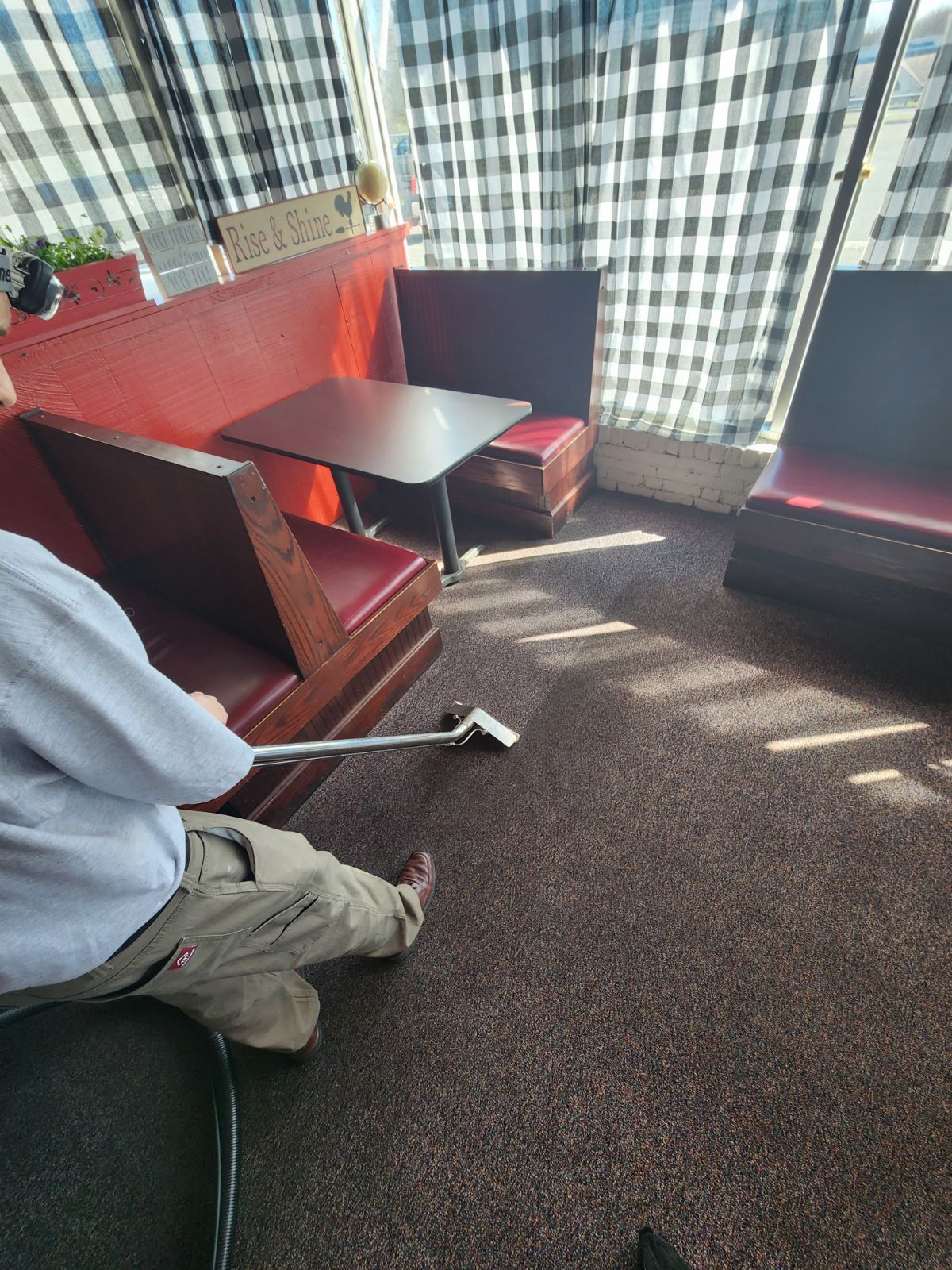

They are doing something, better than nothing, but far from being power scrubbed..
Every tool has its place, but greasy commercial jobs would benefit more from a rotary scrub.. A rotary you could post pad with as well.. I'm glad you mentioned electric vac motors differ from Positive Displacement TM vac.. Smatty boy is tryna setup the noob..
Portable pumps are much different than truck mount pumps as well. Most portables struggle to put out 500 psi on a 2 flow wand.

One more thing, the ones running 5-600psi are also using positive displacement blowers and not vacuum motors. More is not always better.
That's a great tip and to be honest I figured as much. Today I was watching closely and I could see steamy moisture slightly escaping the sides of the world's greatest wand on my portable even at 350psi. Around 400psi sounds spot on for the most I can safely blast anything with.
