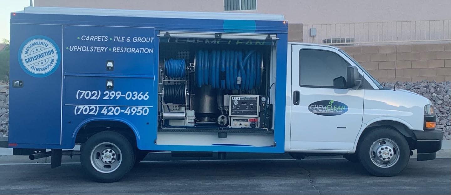

My guess would be blower exhaust .... which could add considerable heat under the chassis especially during summer months
I was hoping someone was gonna say it's an opening to hook up hoses when the box needs to stay closed.
If it's blower exhaust...that unit will have downtime
It should have a 90 so the exhaust keeps your feet warm in the winter.

Look beneath the side door rocker panel ... the 3 inch exhaust pipe extends below the box
definitely not a port hole for hoses
Just the blower exhaust. Quieter under the vehicle. Probably needs a 45 elbow to prevent melting asphalt on a hot day.
14,630
That’s a terrible design if that’s what it is. Not only will it melt asphalt. It will kill grass (yes I park off the driveway when circumstances arrive), blow dirt dust all in and over the truck.
