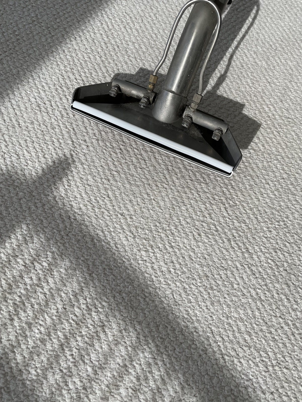

Hello. Coming from a Prochem Quad Jet S bend wand. Has anyone here used this particular Prochem wand and switched to a wand with a built in glide. I personally am not a fan of glides, however find it much more easier to train a tech with a glide. So I'm looking for something comparible. Obviously I can put a glide on my Prochem wand but makes no sense with the weight of the wand. If your gonna glide I am thinking your wand may as well be light. Also wondering if built in glides are in better because adding glide and taking jets up that much higher from surface may not be as good??. I will use a glide every so often on a style of cut pile carpet that is very difficult without. (not sure on the fiber name but it creates too much suction, results have pretty bad pooling look too) BTW, 11 inch wand is choice as well.... Any recommendations would be appreciated.

I learned on a prochem quad with no glide and I used the wand with just a lip glide in one of the lips, a full glide and no glide. The lip glide was the best for that wand for the reasons you mentioned with the water jets not being affected and it still helping train the new guys, yet provide a really good water recovery.

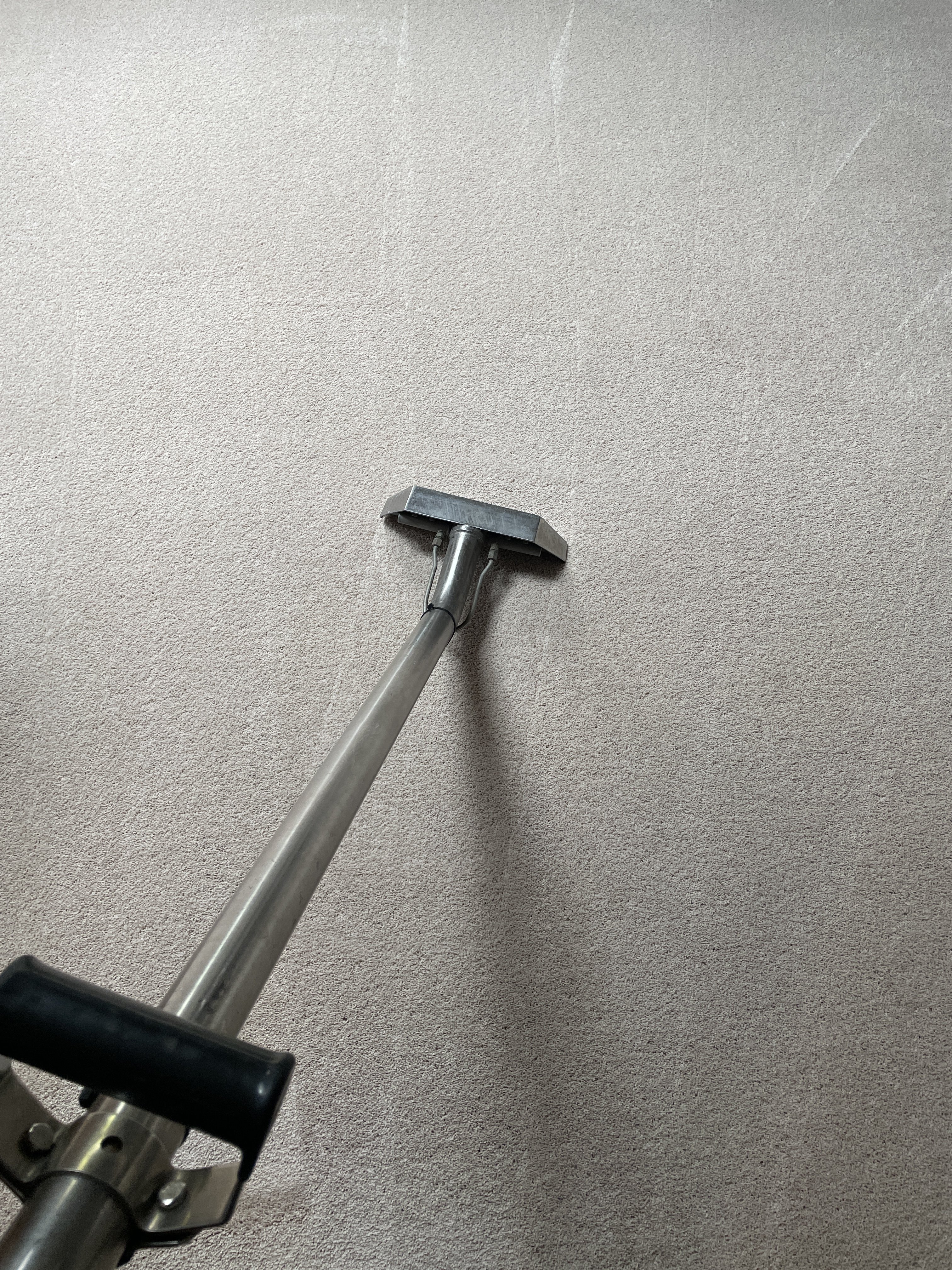

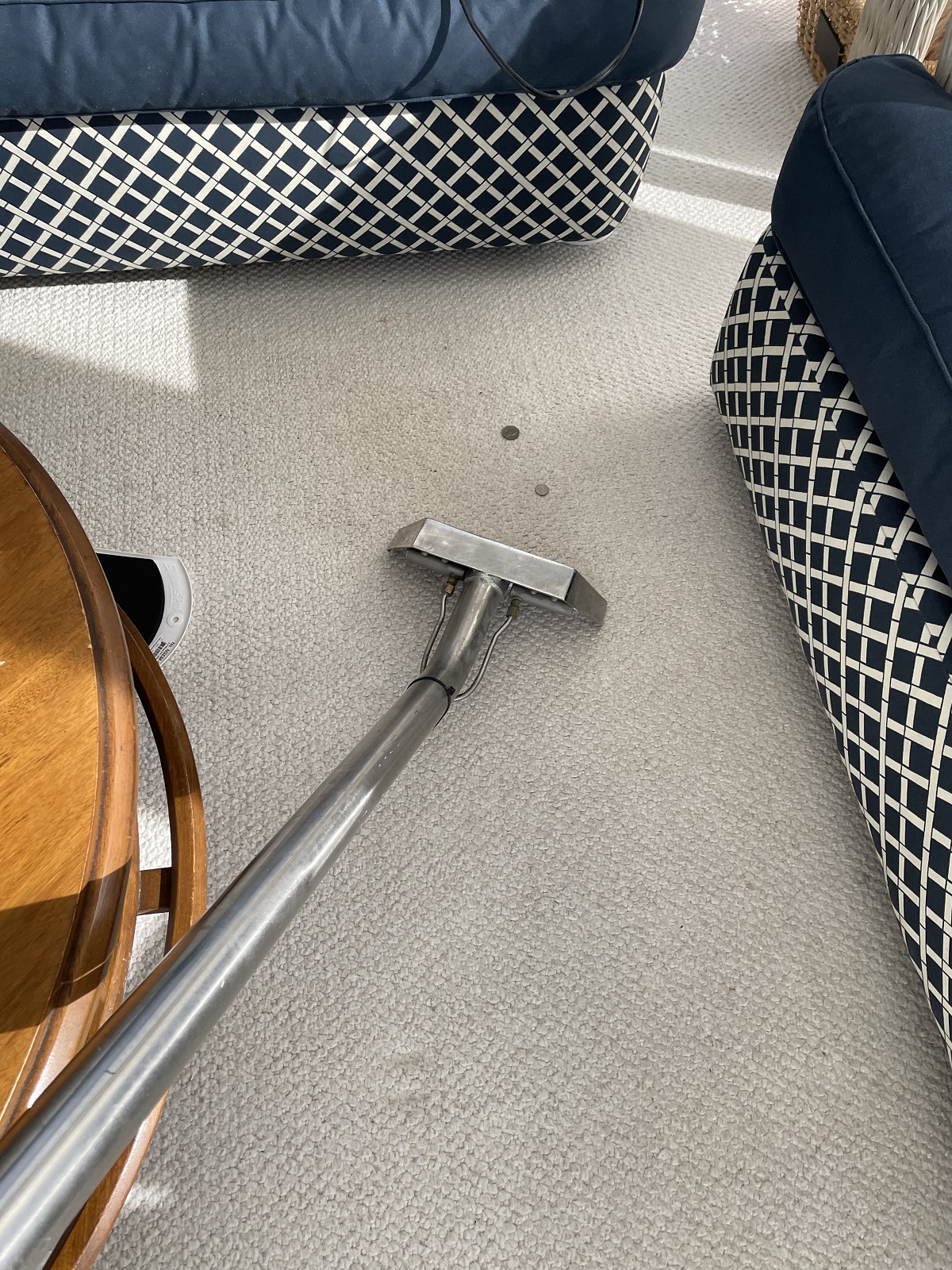

Cleaned over 800 sq ft of old cut pile carpet that usually fights back, return customer of many many years. New lip glide had me smiling the whole job. Some old berber that would have a horrible sound like finger nails scratching a chalk board was not an issue with the glide as well. (Dry carpet in sunroom, old). This exceeded my expectation. I love the fact that you saw my post, had a custom glide that fit my needs for a particular wand, and got it to me, and it worked for me all within a few days. This opens up some doors for me now. Sucked up a dime then a quarter, no problem. First dresser I moved had all kinds of debris and I was able to vacuum up as well. Game changer. Thanks.

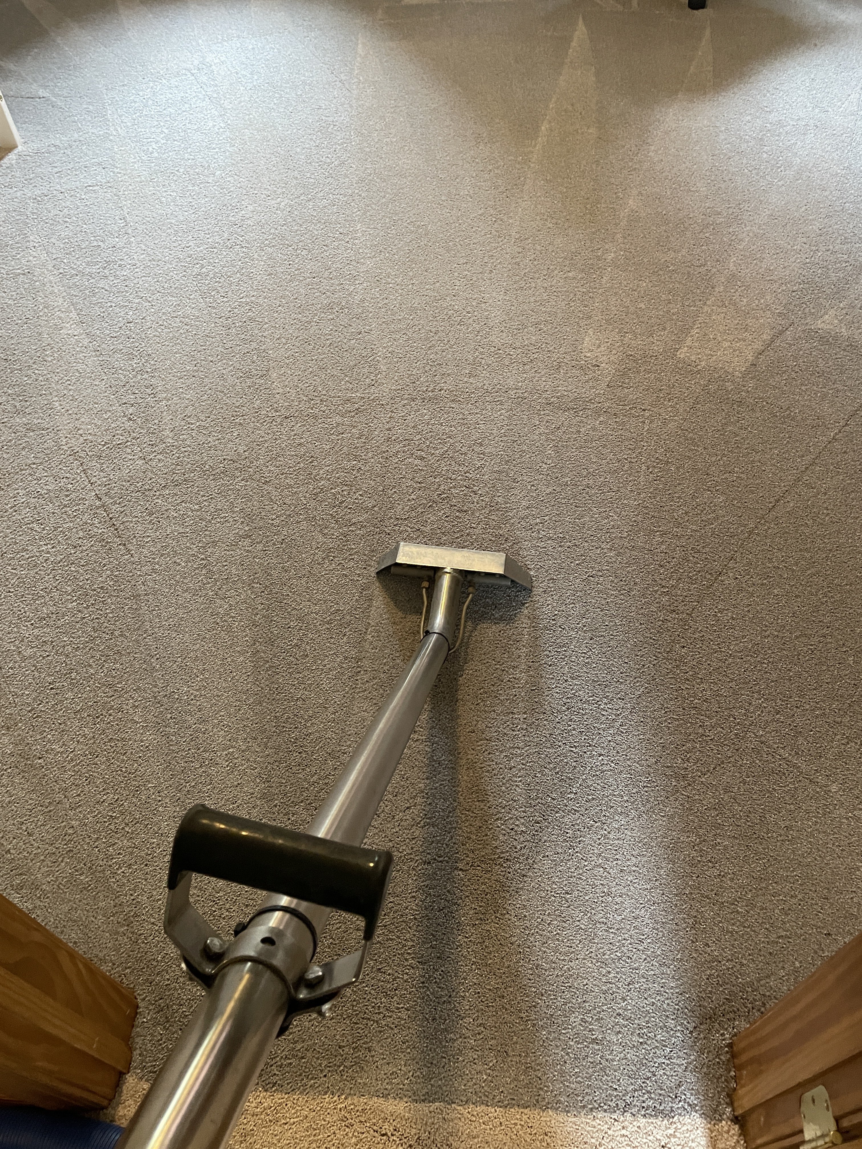

Another 2 jobs today I needed the glide. Timing couldn't have been better. This was about 450 sq ft of super resistant to the wand cut pile carpet, seriously would have destroyed my day. Came out real nice, almost didn't want to groom it. The effort was perfect. I like the way they are drying too. Ended up with a bonus job next door for a small rug. Used it there too. This is litteraly a game changer.

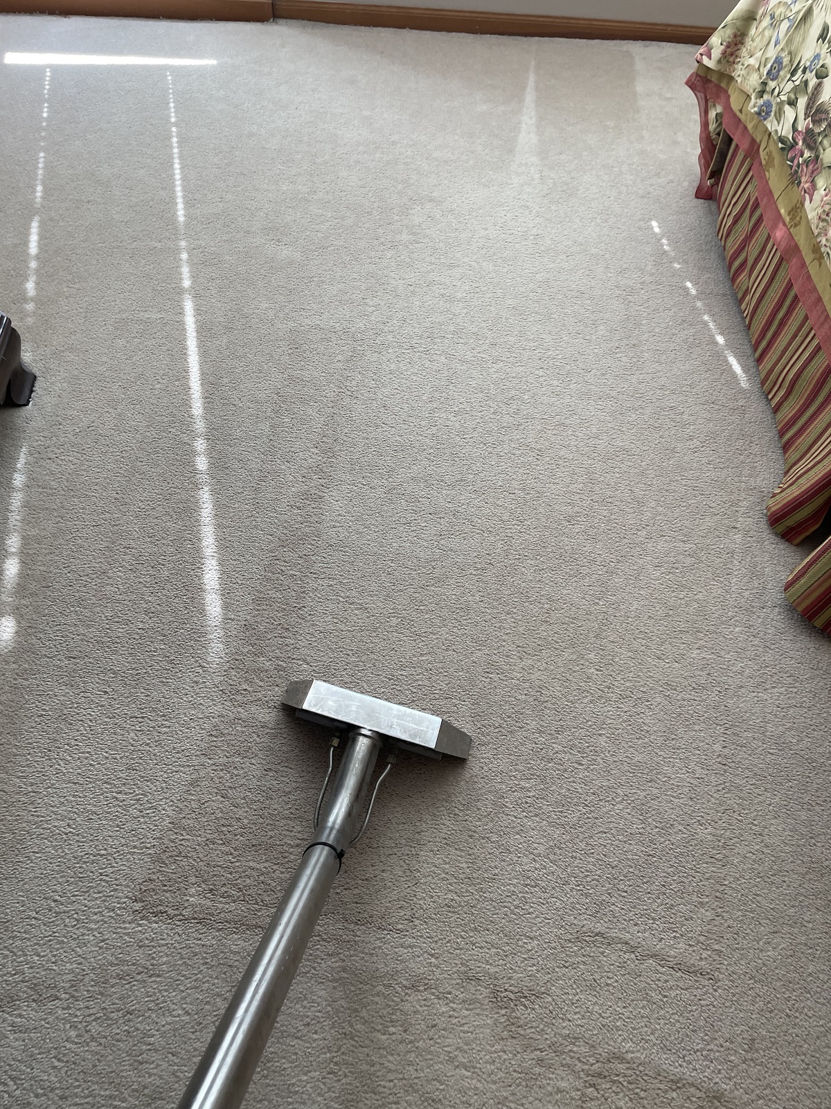

Such a game changer. Did miles of a historically back breaking carpet yesterday. This lip glide made it the perfect job. I would say I use it on at least 80 percent of jobs now. Better late than never
