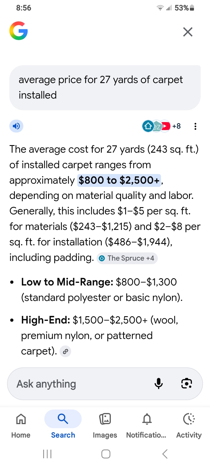

I would say thats alot!! 55-66.00 per yard, but googling it that's mid range for high end carpet
