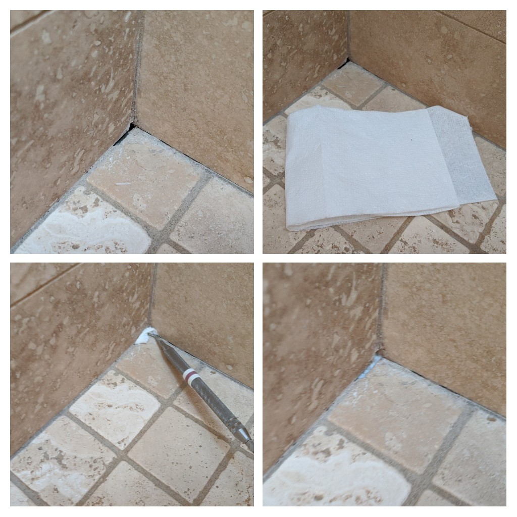

End of the world backer rod.

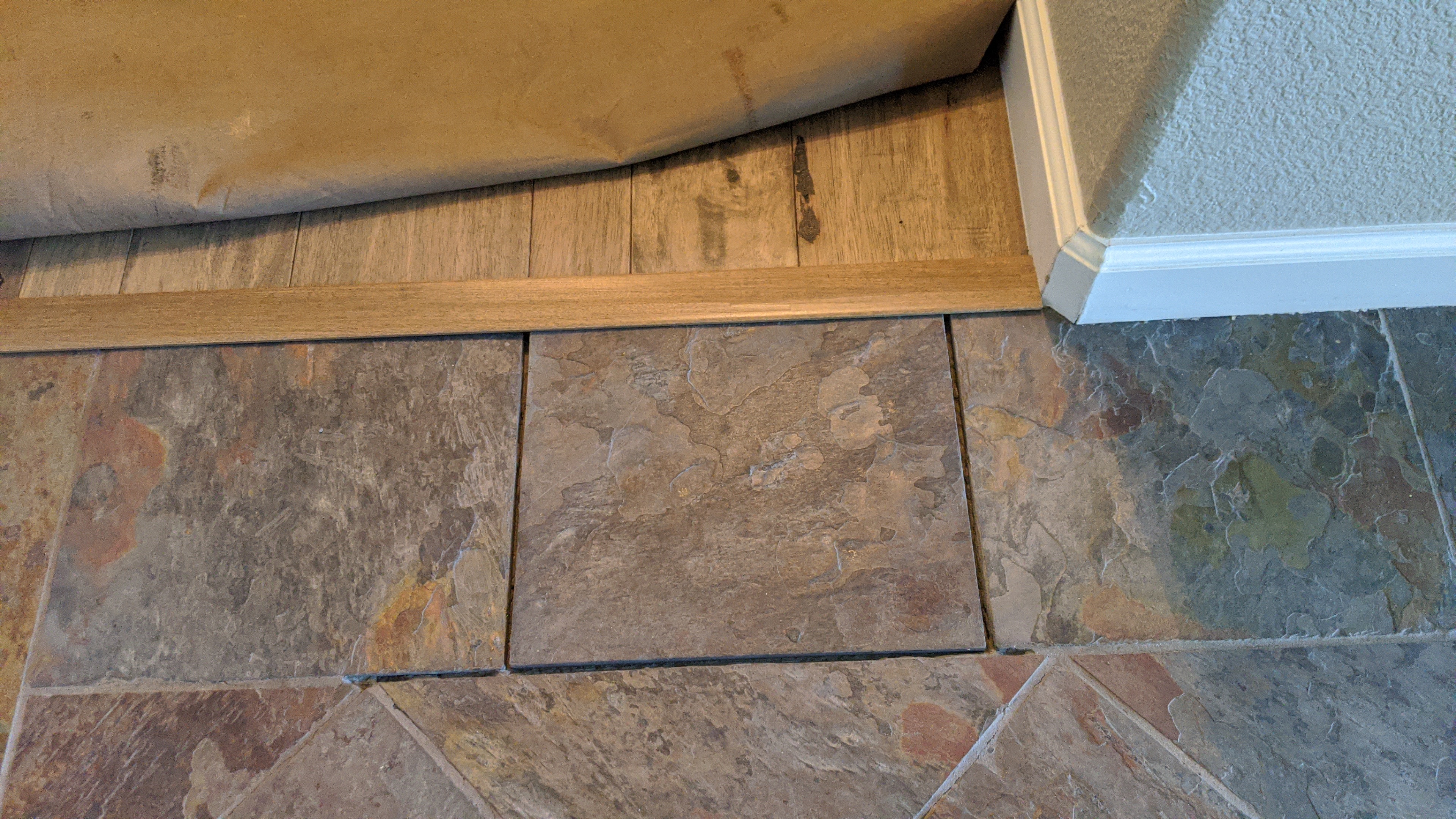

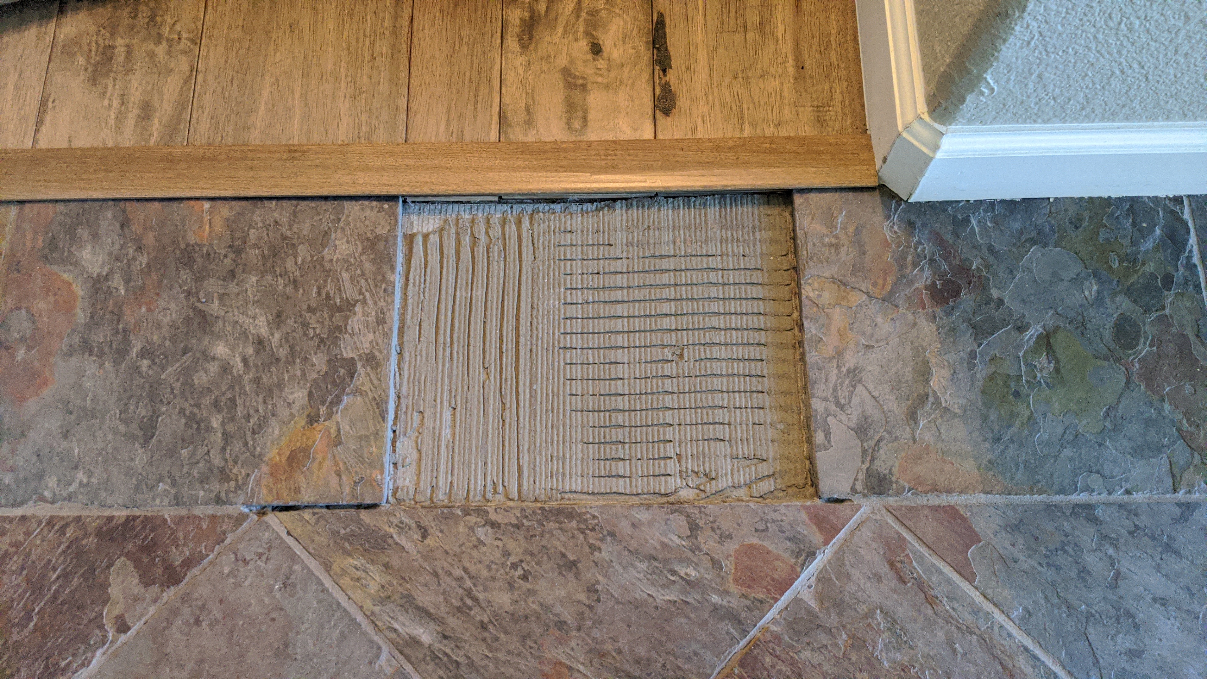

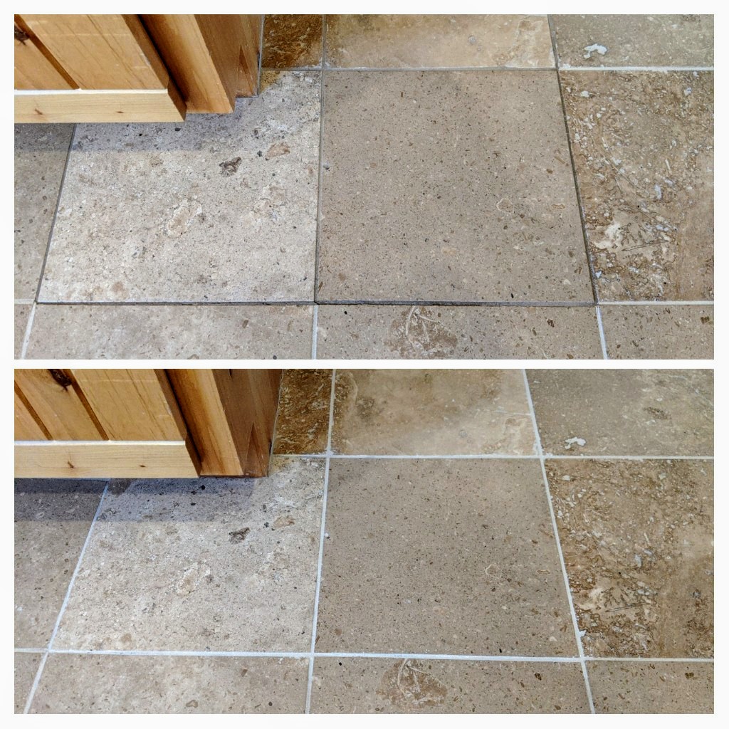

handyman replace these two tiles and match the new grout that dirty old grout well guess what happened after I clean the floor...
SGA to the rescue again

so paper towel as a backer rod?
IMHO over complicated the missing grout repair. just use prism grout- done

My question is why do you it's necessary to use SGA for that situation? Does it break frequently?
more complicated?
customer has grout in garage.
I have SGA in van.
done.
TP to plug holes so all the SGA doesnt fall into the Bermuda triangle
Prism is a matsa cracker compared to SGA

"use what you got"....
was SGA overkill?
sure but I had some on the truck and he had the grout, why complicate things.

charge to remove 125 ft? linear ft? charge your hourly rate. a lot of variables, one being how hard the grout is and how delicate the tile edge is. in most situations i would not even be interested.
with prism grout- no grout shading, cures fast, 1/16-1/2 wide.
negs: will scratch polisheds stone, cost more,

And replacing with just grout or sga? Watched a video that only took 1/16 off and put epoxy grout on top. Wasn't sure what ya was gonna do.
