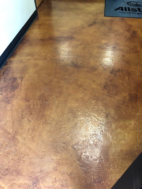

Customer said floor needs cleaned and wants it to shine.
I think the floor is acid etched and dyed.
This is the first time I've run into this kind of floor.
I have a rotovac CFX/Ranger.
I also have a Trinity Phoenix, a 175, and a Multiwash.
How would you do this job?

Neutral cleaner low heat and pressure.
If it has a flaw in the application you will find it if you are too aggressive.
If I couldn't wand it I would mop it.
9,863
If you want it to shine like the owner wants, scrub it like top coating a vct, apply two coats of finish as a sacrificial coating. Bam!
