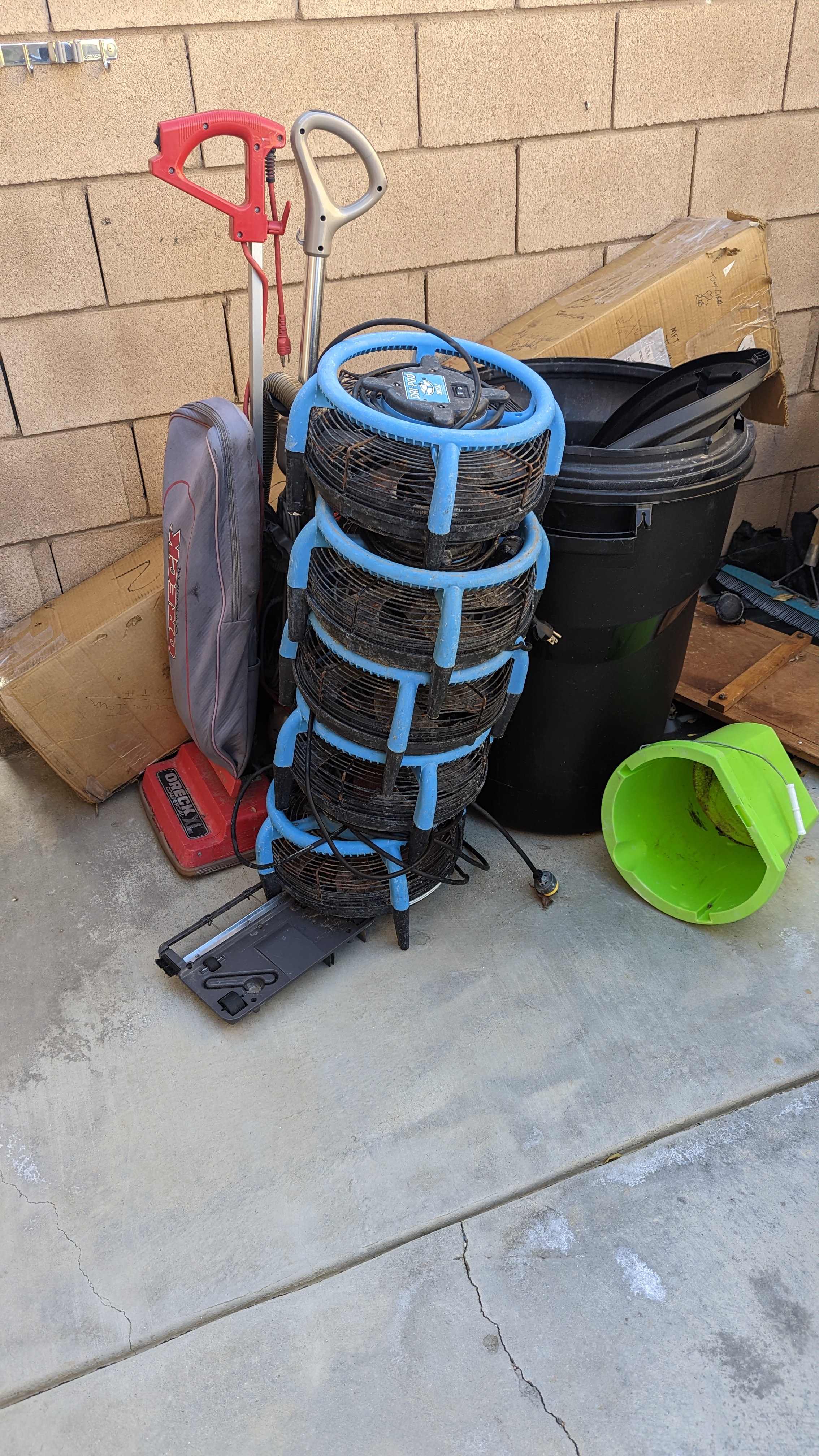

Snapped a leg off a Dri-Pod a year ago. Fixed with epoxy, which worked well until a few days ago when I hit an unseen speed bump that launched all the fans in the back of the truck. All survived except the one I epoxied :(
Spoke with my distributor who said parts are not sold for the fans. Can this really be true?? I need the bottom diffuser with the 4 legs. The rest of the fan is in great shape.

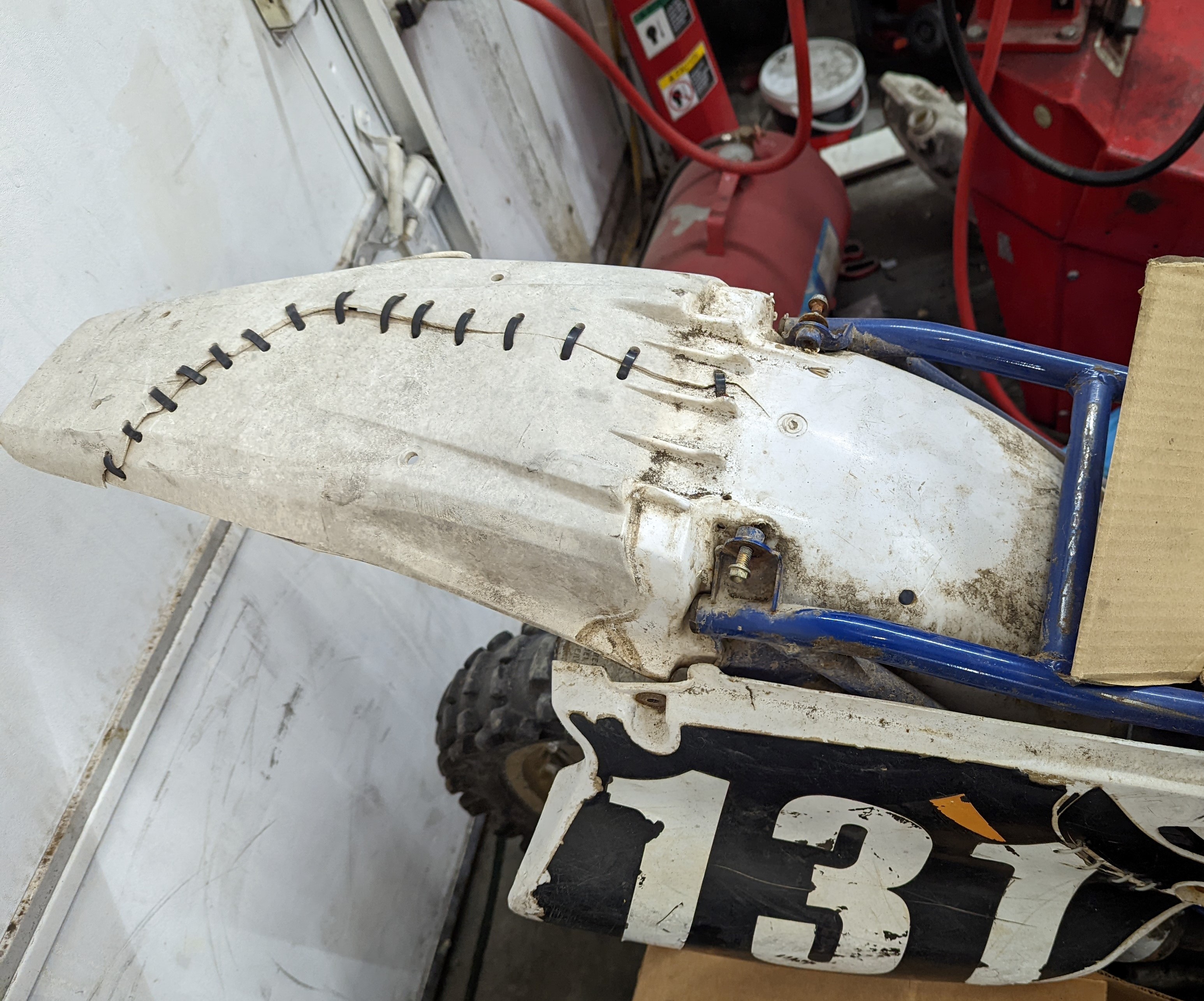

Have some fun with it. Use one of these.

My friend has one of these.. Works well for a lot of things.. You can get the cheaper ones.. It uses staples that heat up and you melt it into the plastic to repair it.. So far it's holding a bumper on a car, a proteam vacuum head, and a few other bits I've tried it on..

can confirm....used one to put the rear bumper assembly of my kid's car back together
