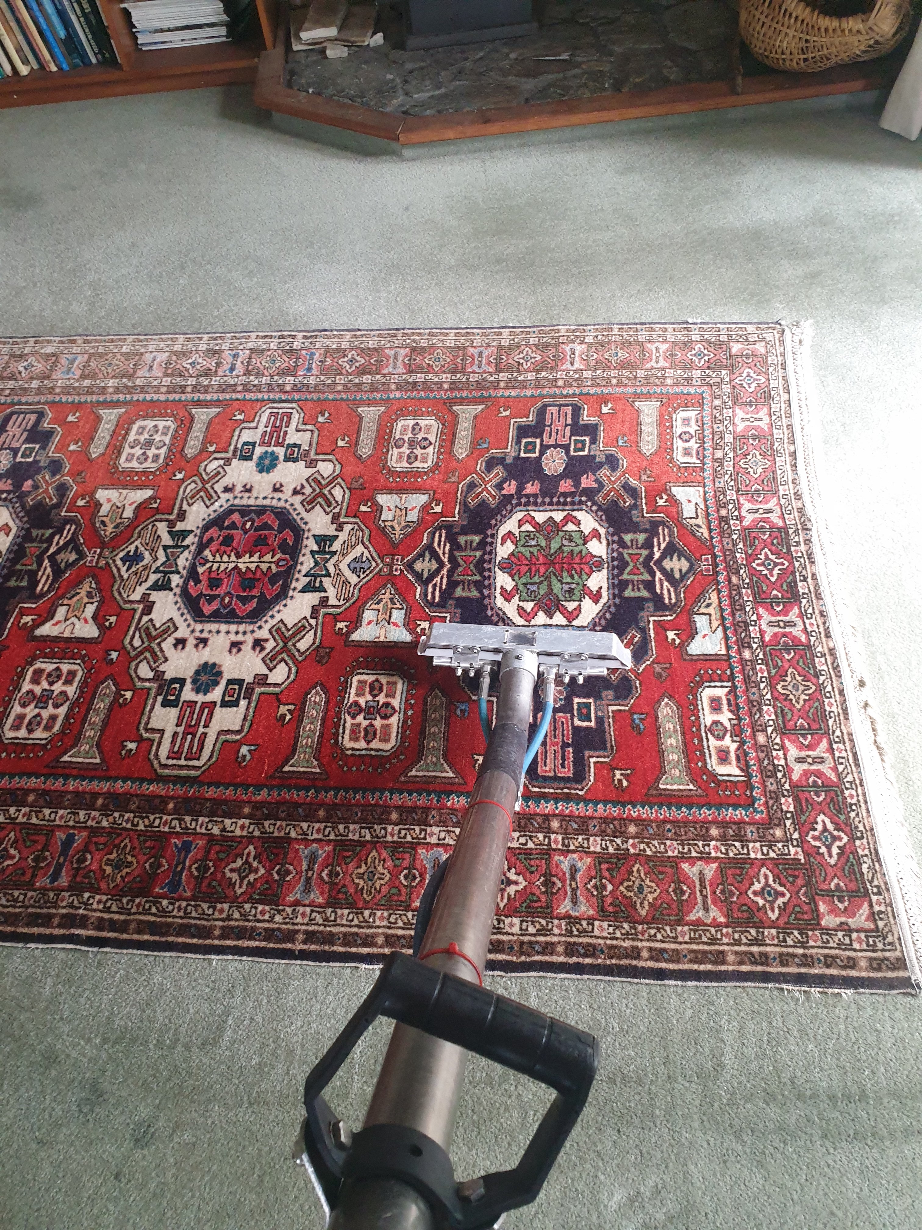

Place a sheet of plastic under the rug and clean it where it lies.Last week, I cleaned 4 very valuable rugs ($8kish each) in the home. The customer was insistent that it be cleaned there on top of the hardwood floor. They said the previous cc had no trouble with cleaning it on site. Iranian rugs with very bright red and blue colors. I did the normal with treating them with a neutral prespray and CWE with wet passes on the pull back only, and the acid rinse turned on. They came out great. It's one of many rugs I have cleaned like that with no problem. I was more concerned with the bright colors possibly bleeding but they cleaned really well.

I don't know why I never replied to this comment, but it's very good advice for new beginners in this business. Because the newbies need to take these exact precautions until they're fully aware and informed of cleaning the rugs and which ones are safe to clean in the homes.Last week, I cleaned 4 very valuable rugs ($8kish each) in the home. The customer was insistent that it be cleaned there on top of the hardwood floor. They said the previous cc had no trouble with cleaning it on site. Iranian rugs with very bright red and blue colors. I did the normal with treating them with a neutral prespray and CWE with wet passes on the pull back only, and the acid rinse turned on. They came out great. It's one of many rugs I have cleaned like that with no problem. I was more concerned with the bright colors possibly bleeding but they cleaned really well.
