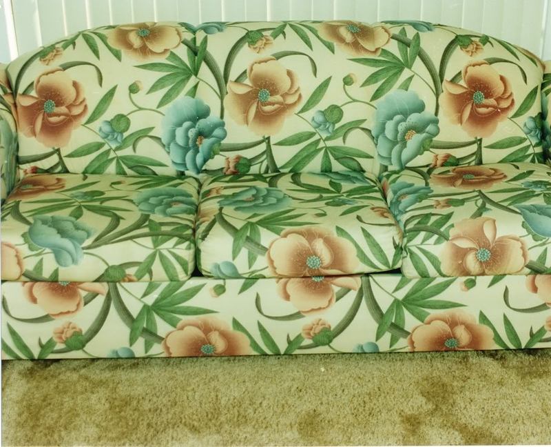

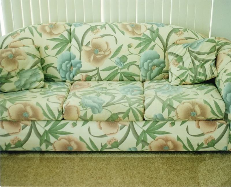

I like to boost my cleaning solutions, pre-sprays and shampoo solutions, particularly with upholstery and area rugs. It seems to help bring out the hidden colors.
Here is an example of a cotton print sofa that I was asked to clean for a management company and they just wanted to get 'one more year' out of it. It wasn't really 'heavily soiled' but just more dull and lifeless.
Here it is after cleaning with a booster and lots of agitation and so on.......
The results got me a lot of work from this management company.
What I like is the way colors seem to come out much better. Many times it seems as if something that is dull now has the old oxidized oils and soils removed and the light reflection brings out the colors that were simply hidden.

Thanks for the comments. It takes about as long as a normal cleaning for me. I always hand clean along with whatever I will flush it out with.
Good question Fred, I should have stated that already, Yes, it was dry, That photo was the next day. It can be amazing how much difference there is when the solutions have time to work and dry.
