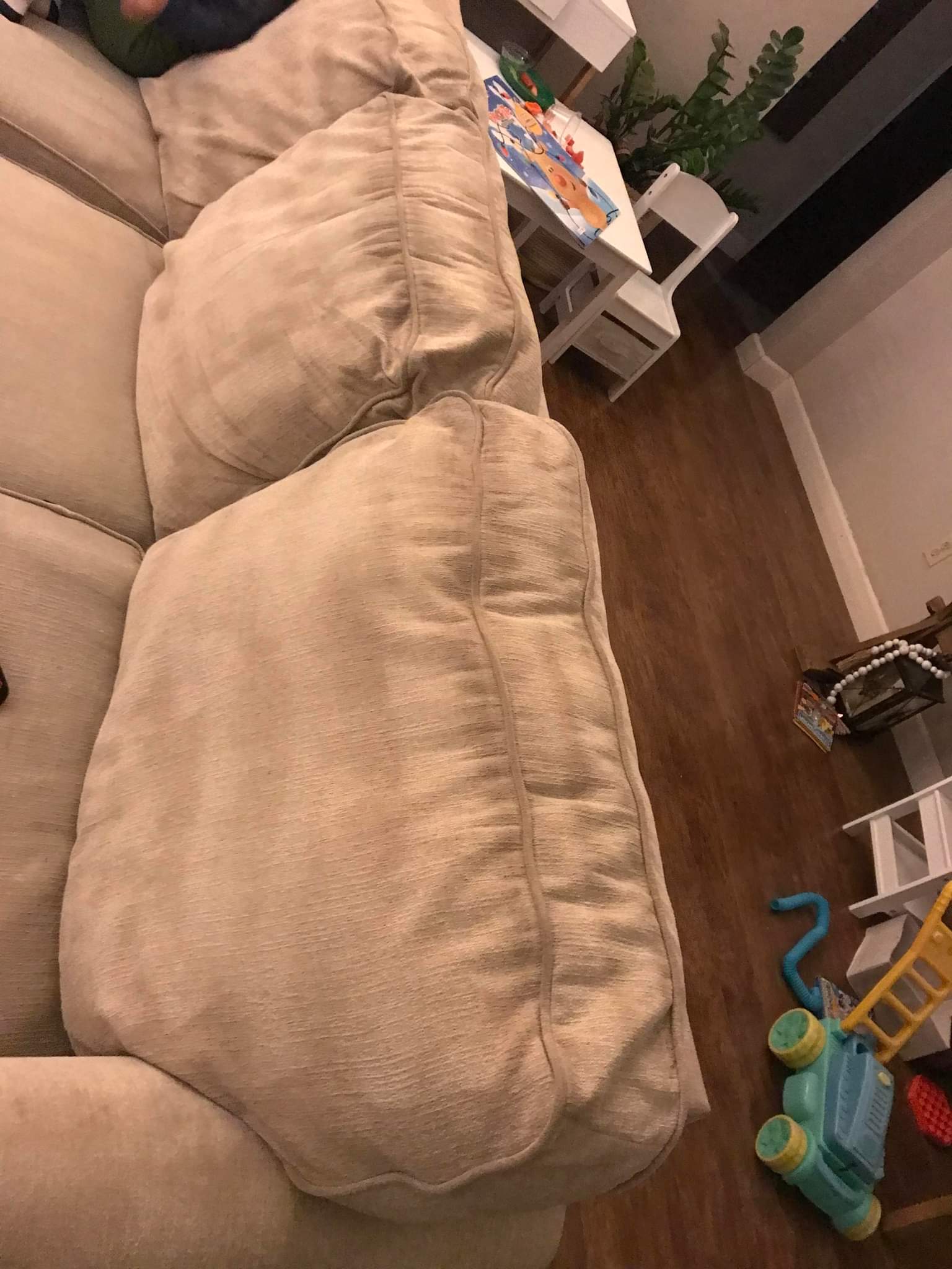

To start things off I'm fairly new to the trade I recently did a couch and the next day after the couch dried these dark streaks were left how do I get rid of them

Test your hoses by turning up the pressure to about800, fill half a white bucket up and see what color the water is. If it's not perfectly clear and has a grey tint or even dark grey, you were cleaning with a bad hose and that is dirty, rubber water on that fiber. Clean again with a new hose

Go back and clean it again.
This time do what Nate said.
Ignore Matt.
He’s an idiot.

Looks like what happens if you have an unbalanced pmf enclosed jet tool. Too much pressure in the center, not overlapping fine enough. Either turn the pressure down or reduce the vacuum. Overlap closer. This piece will have to be presprayed and cleaned again.

Looks too uniform a pattern for goodyear crap water. Spray bottle rinse, agitate, vac, towel out any vac lines. Oh and sell protector.
12,853
Reclean it
dont over apply your prespray (no hydroforce)
agitate your prespray particularly in problem areas
rinse and DRY STROKE
towel off
Follow Dan's steps above
Also, the jet can be pushed into the head too far by the pressure of your hand on those tools. It’s a good idea to back it out a bit and tighten it up.
Use the tool exactly as Marty says here when you do this. Most of these are caused by pushing the tool down as Marty mentioned.
Let's see your tool. I've seen the tool Ron mentioned here as a problem at times. It is also called a "Hydry Tool", "Freedom Tool" or "Internal Spray Detailer"

You may be able to use a wet rag and fix it. If not reclean and make sure to wipe the fabic int he same direction after cleaning.

What tool, pressure, heat temp, process did you use to clean it?
Looks like it got over wet, temp possibly too high along with the pressure as well.. Upholstery doesn't need high pressure or temps..
Dry stroke well and groom/ use a towel to lay the pile in the same direction..
I used an internal spray upholstery tool my pressure was at about 600 the process I vacuumed, presprayed let it sit for like 15 minutes, agitated, then extracted
28,275
Turn your pressure down to 300 psi. Take your tool and spray without any vacuum, then hook up the vacuum and observe the difference. Make sure your jet is centered in the vacuum orifice and isn't to close to the walls in either side. If you have a vacuum release, play with it to see what difference it makes. I use these tools often but they have to be balanced.
