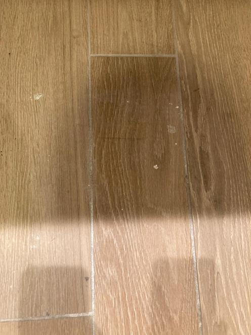

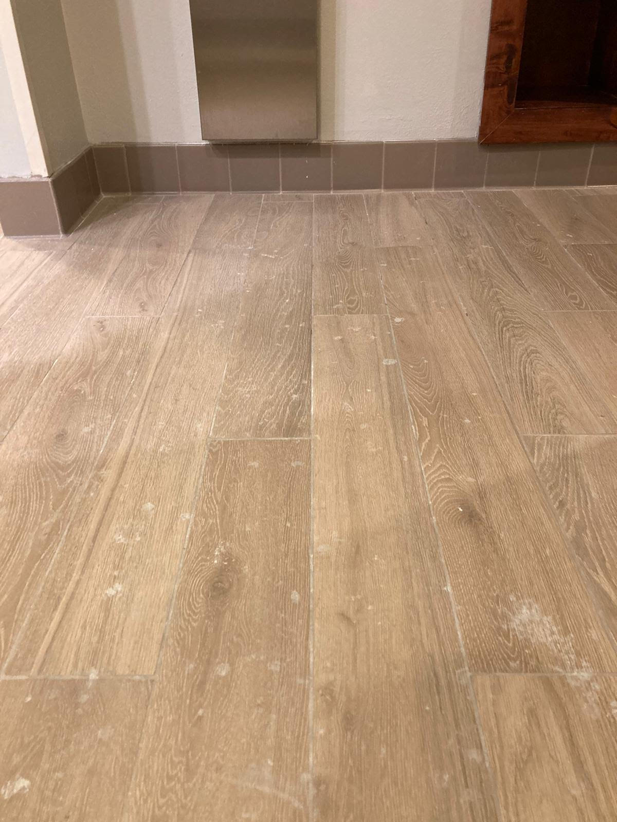

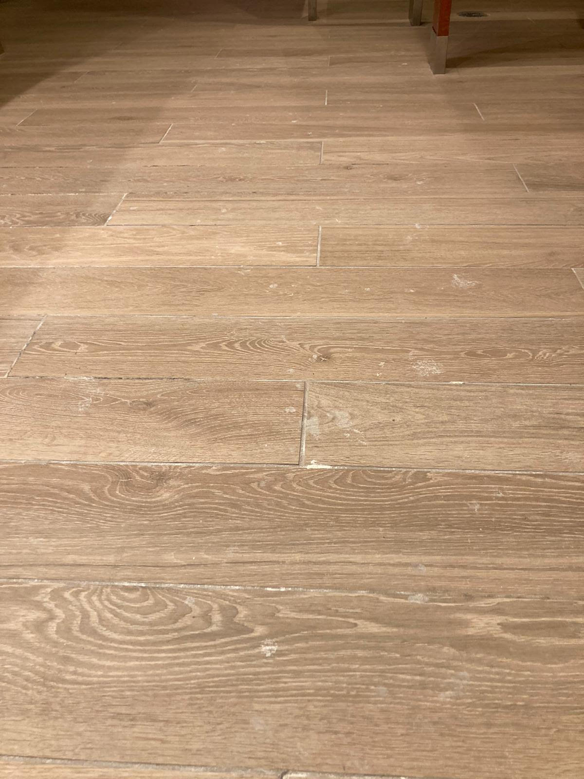

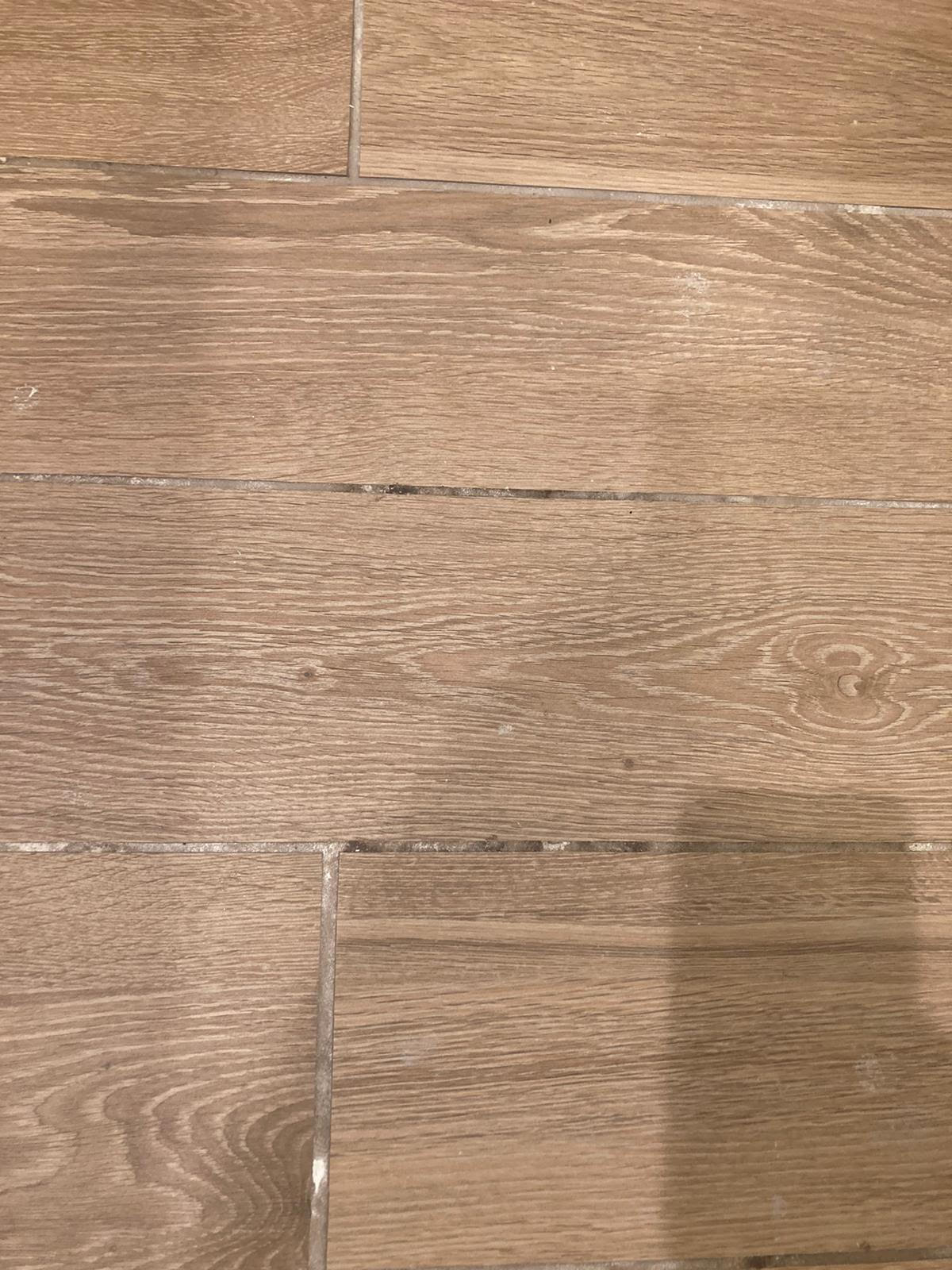

Here's a challenging one I have to go inspect this week. new install in a Marriott, epoxy grout & porcelain plank splattered in construction gunk- paint, drywall mud, food etc... Most likely I will NOT be able to use my truckmount due to logistics..
175 and hopefully a garden hose rinse to a floor drain.
Thoughts?
