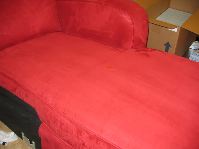

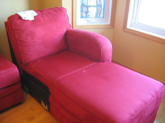

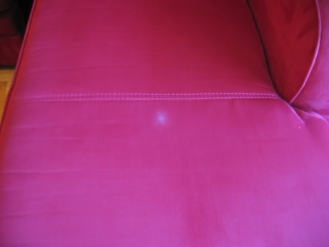

Did a burn test, all I can tell is that it is synthetic burns down to hard ball and has a white cotton backing. Found a marker pen that I thought was close and depending on light and lay of the nap looks not so good:
or not so bad:
Will return piece to customer and see what they say. Thanks for all the help
12,849
Your burn tests confirms synthetic. All that I can imagine is that it might be nylon (there is some nylon microfiber out there) that wasn't dyed properly.
The repair looks better than the fade; if your customer is a decent, understanding person, I'm sure you'll be ok.
