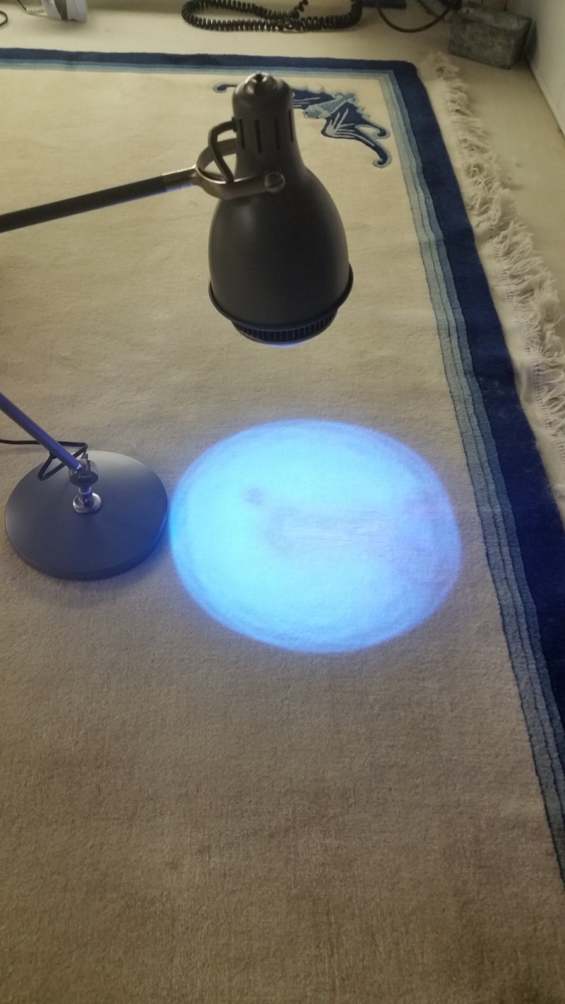

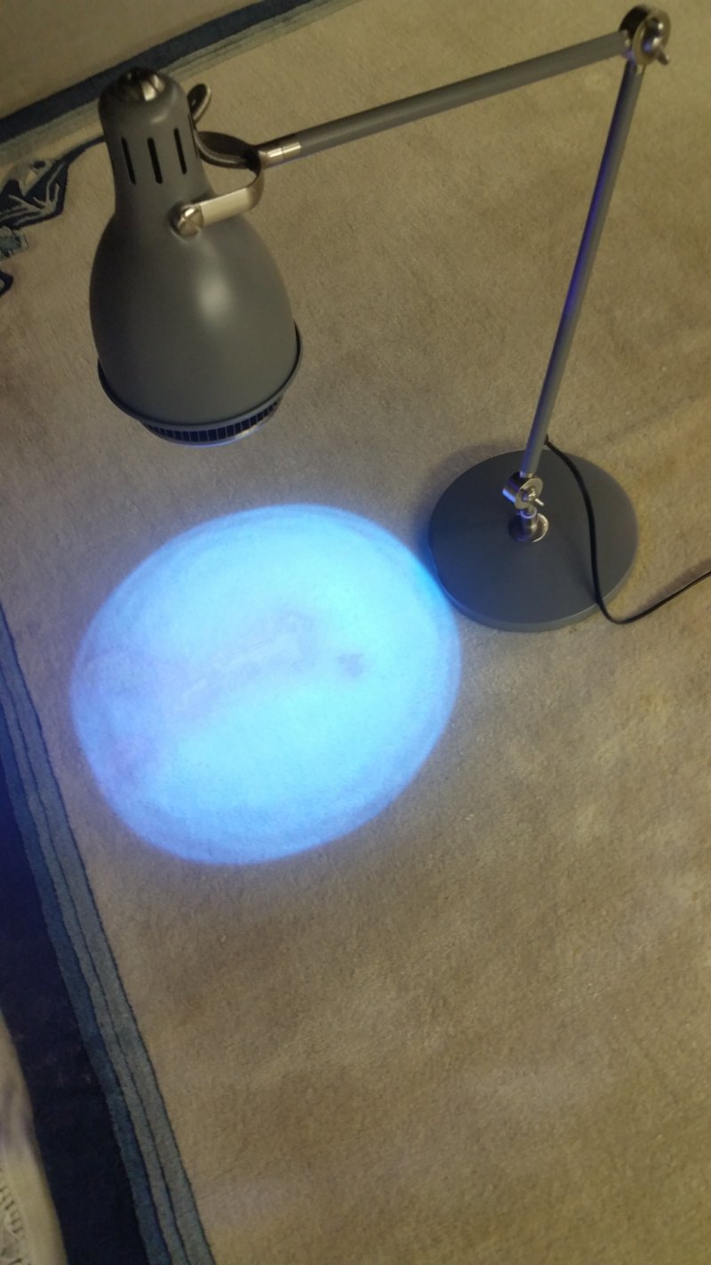

Yellow stains of unknown origin continued to exist even after two washes and a series of H2O2 treatments. The light is now being put to the test.
More results will follow.

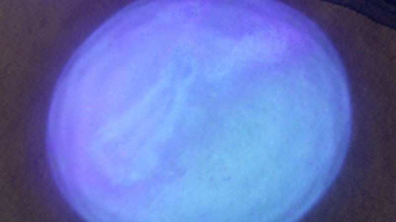

14,631
So how are they different?- both seemed the same to me.
I don't have a picture on hand, but an untreated spot will show a light yellowish/greenish reflection. And the treated spots will be a white/purplish reflection.
