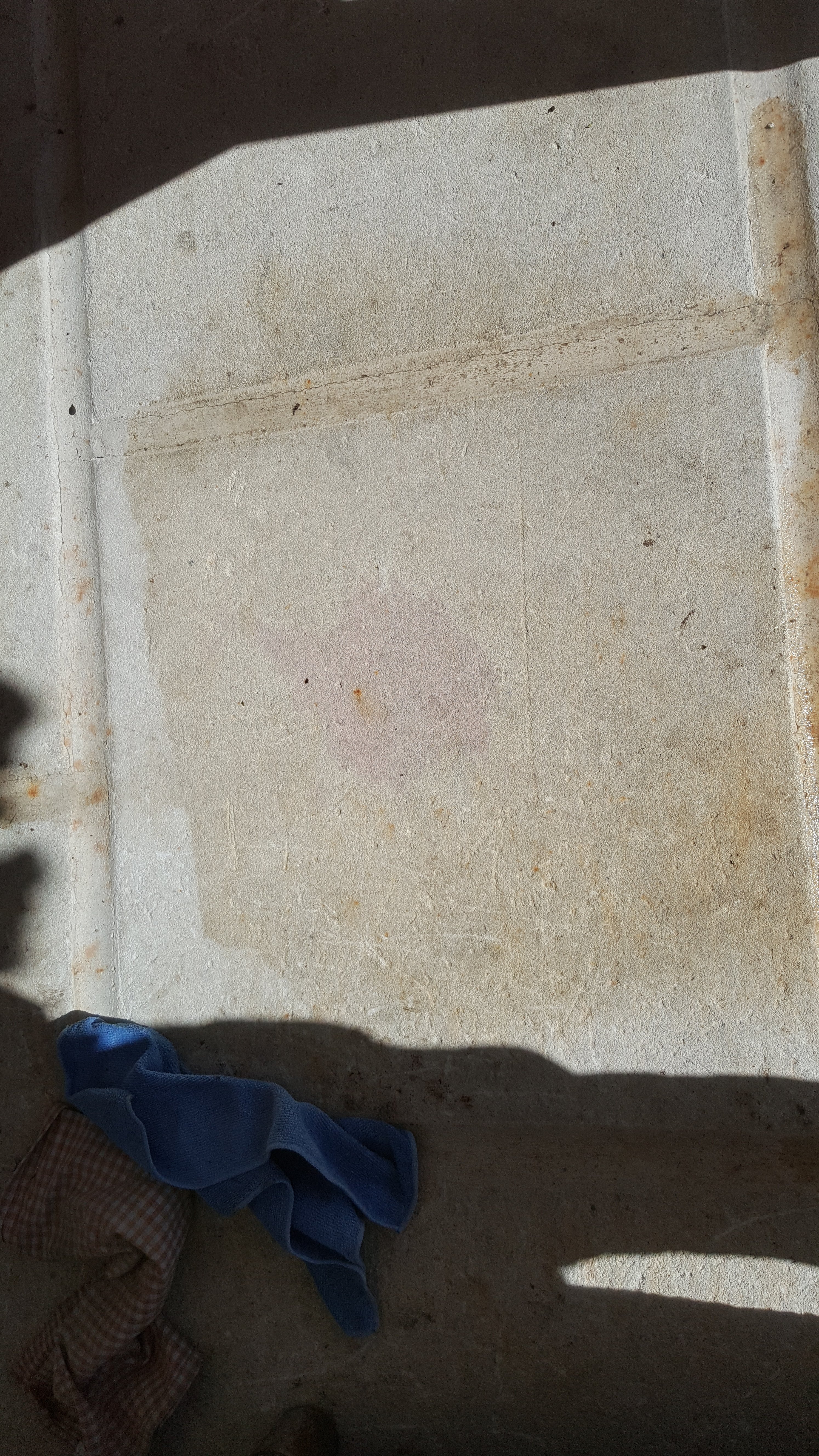

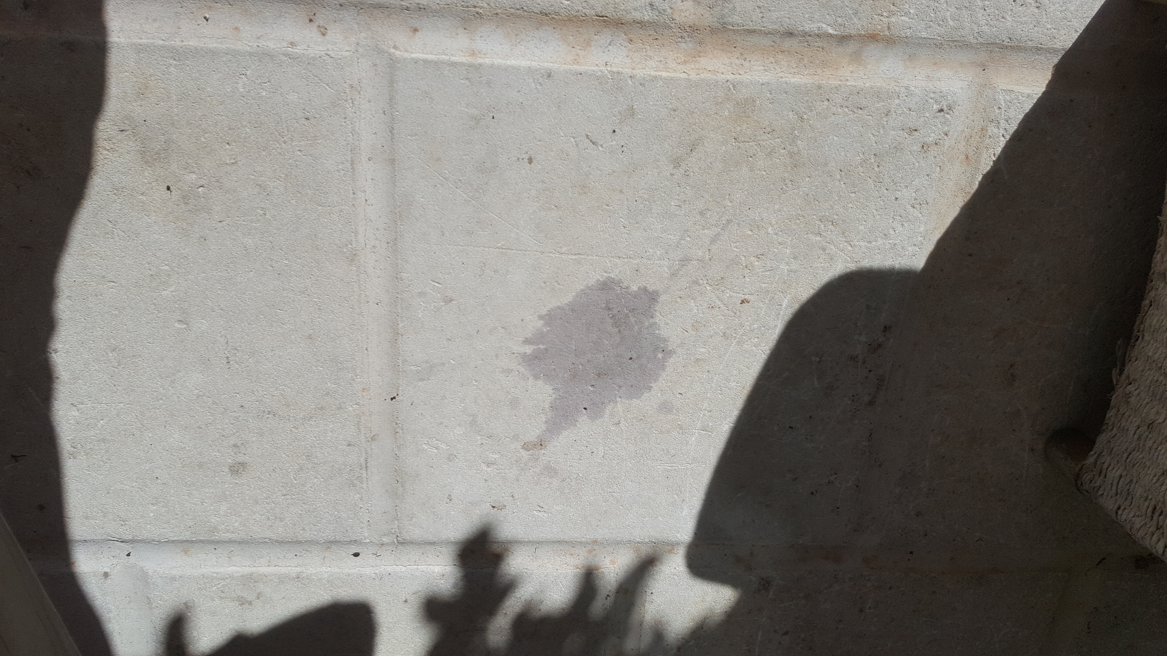

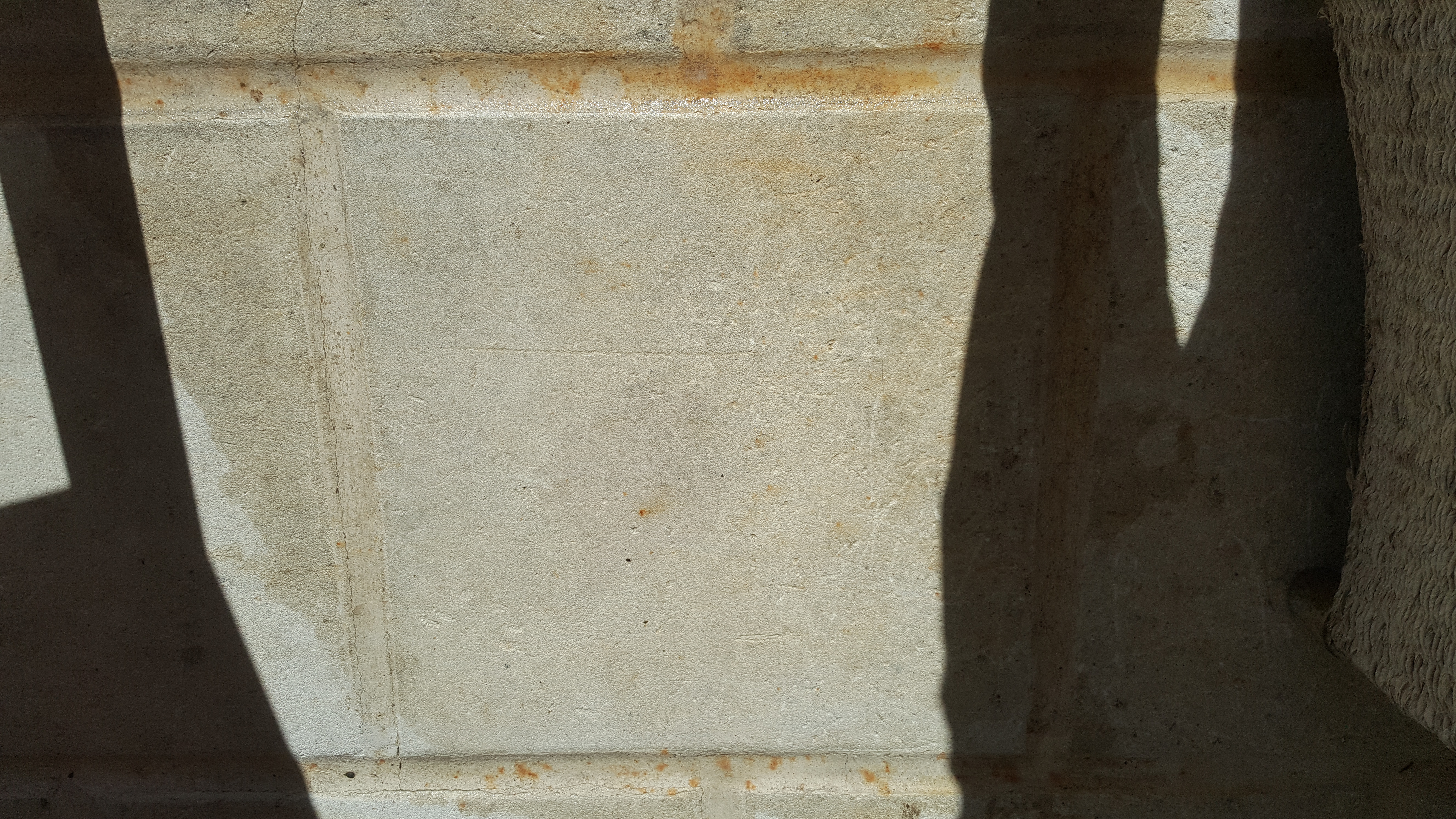

Limestone with red wine on an outside deck I did today
Before I started
Hack Attack
Dec 19, 2017
5,620
Dan
After 20 min dwell with 6% hydrogen peroxide and low pressure rinse
looks lighter but more pink
