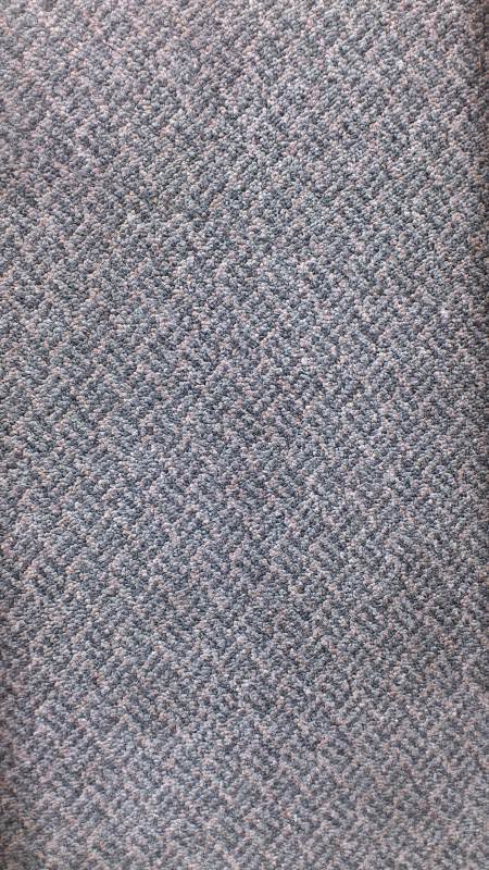

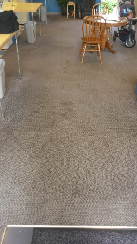

Asked to quote cleaning this carpet, olefin berber in a laundromat, lots of spilled soap
cleaned recently by a local budget cleaner, not really up to date on methods or chemistry
Gets lots of wick-back, the soap doesn't get rinsed out well enough to prevent reoccurring spots.
I was thinking to prespray with a defoamer then rinse
Possibly even to Cimex it after it dries.

Yes. Encap it is the only way to go on that one. You could quote .40 - steam with no guarantees, or .50 - encap with guarantee. Even if you cleaned encapped twice, you would still be ahead of the game. 8)
I would padcap that before/instead of the mex.

Use Chemeister's RinseMaster.
As a prespray and rinse
It was formulated for jobs just like this

Ron I do a few day care centers, they mop the carpet with soapy water.
The only thing that works for this is to run downey in your rinse tank. 3gpm about a quart to 5 gallons.....
