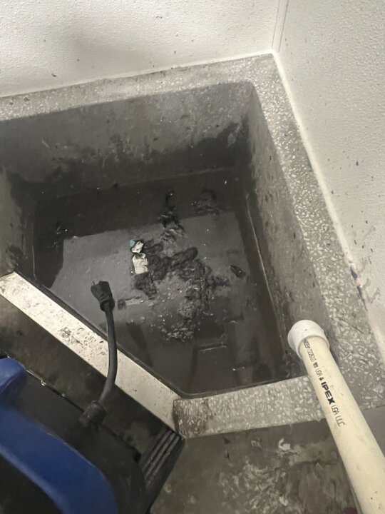

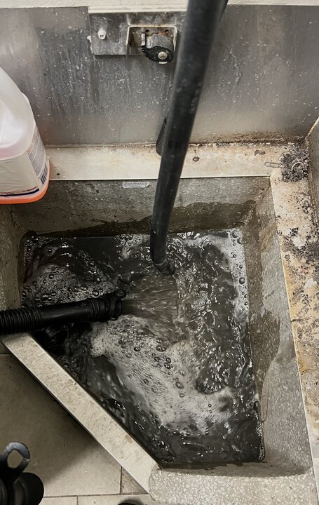

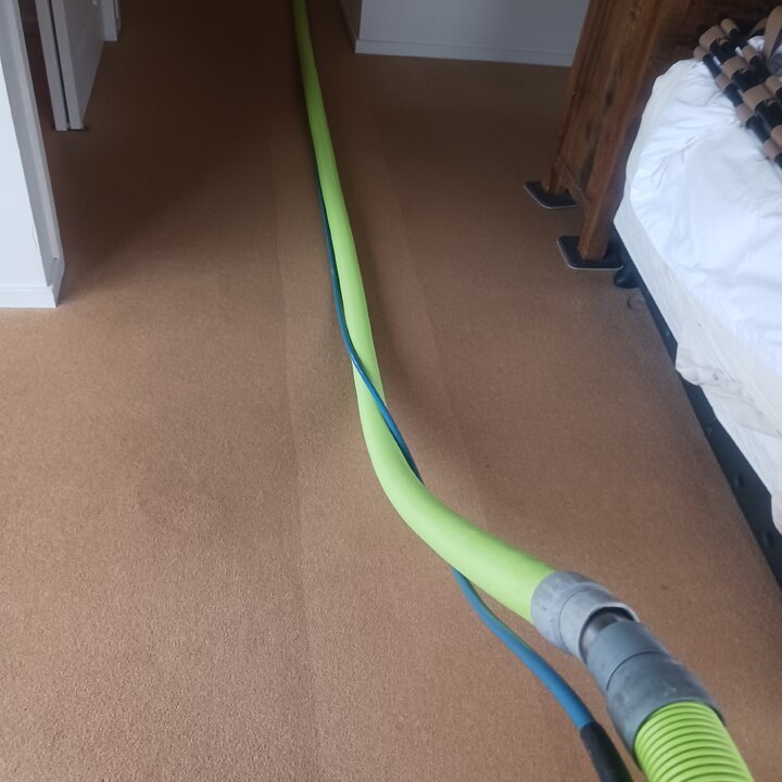

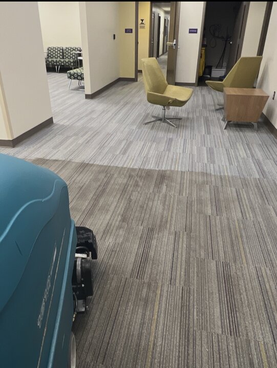

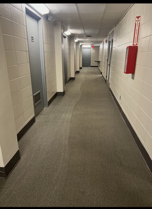

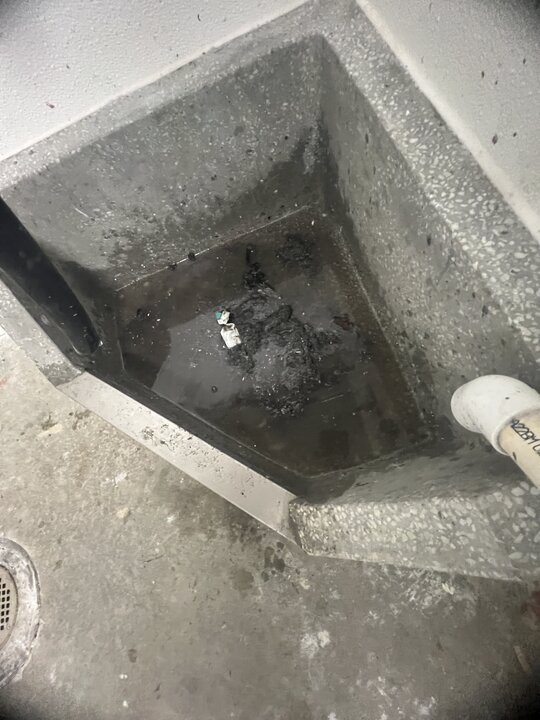

I’ll be honest I’ve been doing this for a long time. I’ve used Portables walk behind ride on extraction. I’ve done a little bit of encapsulation cleaning, but to be honest I just don’t see how the soil is removed. I get it it gets on the pad but after a while aren’t you just smearing dirt on top of dirt don’t kill me guys I’m just not seeing it when I’m pouring filthy water out of a portable or any kind of recovery tank. I can’t help but feel like I’m removing the dirt convince me otherwise please cause it seems to me like you guys are killing it with the cimex. These pictures are recovery water out of regular portables not heat dual vac 220 psi pumps . Also the halls are walk behind tenant 1610 dual crb with 220 psi pump and dual vacuum motors. I also run Titan 875 units . Use prochem ultra pack prespray and all fiber deep clean rinse. How does the pads remove the grit that breaks down the carpet fiber
Reactions: they live
10,149
How long does it stay looking like that? With a good encap product, you can use your pads to do the same as a Cimex. There's no denying that. It's not agitating as well as a Cimex.

Does the cimex extract the grit? We extract those areas every 6 months . I’m assuming the extraction part of the cimex comes afterwards correct with a vacuum with a beater bar

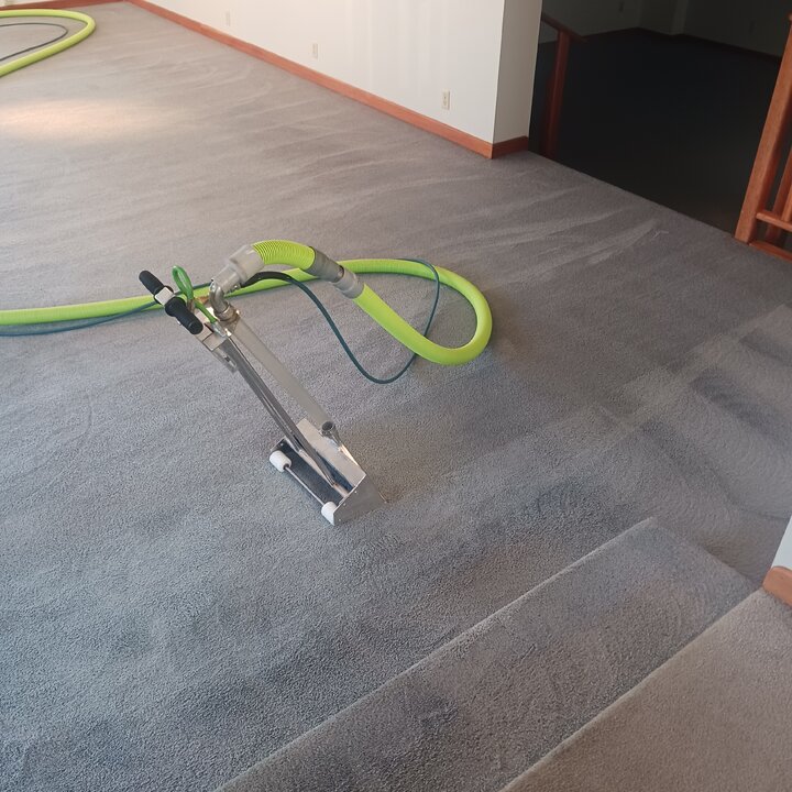

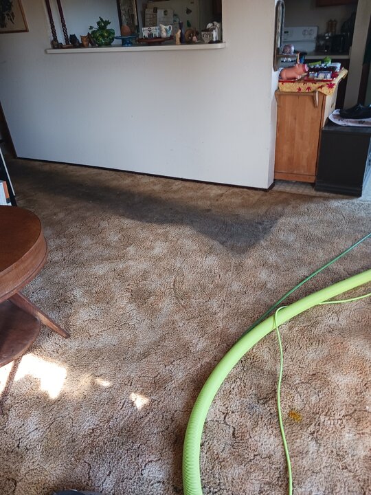

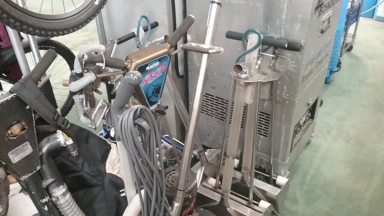

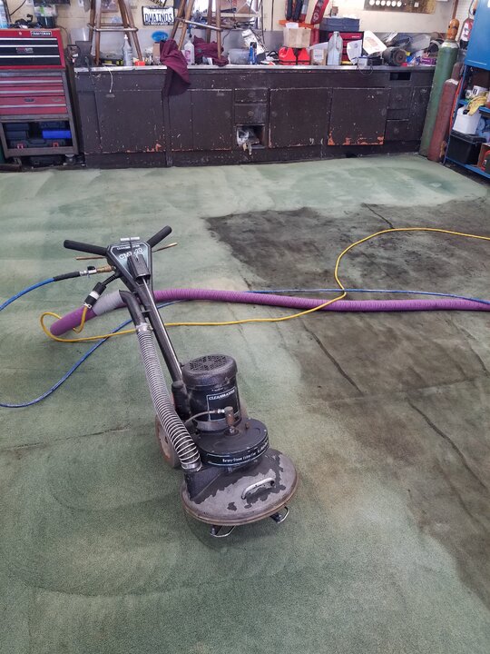

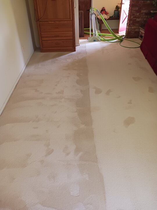

I keep hearing the padder cult preaching less water, more agitation. But i don't think you can get much more agitation than an RX20 or much drier than a weighted drag wand
View attachment 134106 View attachment 134107 View attachment 134108 View attachment 134109 View attachment 134110 View attachment 134111 View attachment 134112 View attachment 134113
I have 2 rx20s. My Cimex will scrub better on cgd. Plus, no Dang
drag wand Dwain, if ya gonna drag
something, make it a zipper!

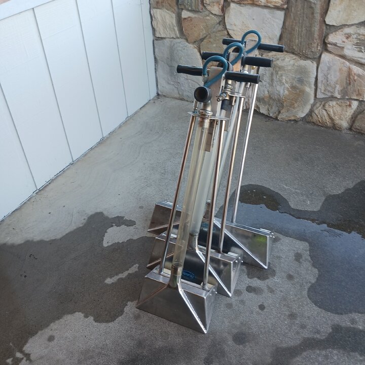

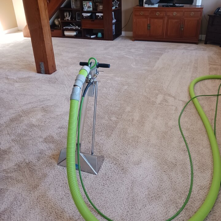

I've tried 3 other types of wands and go back to my trusted drag wand every time so far. When i went to school(iicrc classes) one of the things they preached was to differentiate yourself from your competitors and highlight that which makes you different . I tell my customers that there isn't much difference between the nylon/ polyester they walk on and the nylon/ polyester they wear . A washing machine uses saturation, agitation to remove dirt and centrifical foce to dry the fabric. And repeats the process to rinse. I do almost exactly the same. When a customer cleans clothes they first prespot i prespray with a hydroforce sprayer, next they put the fabric in the machine and add a detergent. I put the rx20 on the fabric and Frankenstein adds a detergent the washing machine agatates and spins to dry. My rx20 agatates and uses a powerful 47 roots blower to dry. The washing machine then fills again and repeats the process to rinse. I switch to a weighted drag wand and a rinsing agent and repeat the process too. The major difference between what i do and what my customer does is they put the fabric in the machine and i put the machine on the fabric. And that is what makes me different than my competitors. Now ive had competitors say to customers that they do the same as me,but they show up with a scrub wandand tell um they did it twice most don't believe um because of the two separate processes i do. Now if i have to do an estimate for a new customer i have before/during/ and after pictures on my phone to show exactly how much work im going to do. If price isn't there only consideration I almost always win the job. And over the decades of business i have lost a few regular customers to competitors because i couldn't get to um in a timely manner. For them ive adopted an attitude that has proven to be true time and time again that is "you can wait your turn or get someone else, and if you get someone else, next time you're more likely to wait. " the customers that have someone else and come back in most cases turn out to be the most loyal and most referring from that point on. As far as the drag wand goes i have so many and it is so much apar of my identity that it is prominently displayed as a part of my logo

Dwain,
You don't need to change one thing.
Keep doing what you're doing, unit you can't do it no more!!! 👍 👏👏👏
