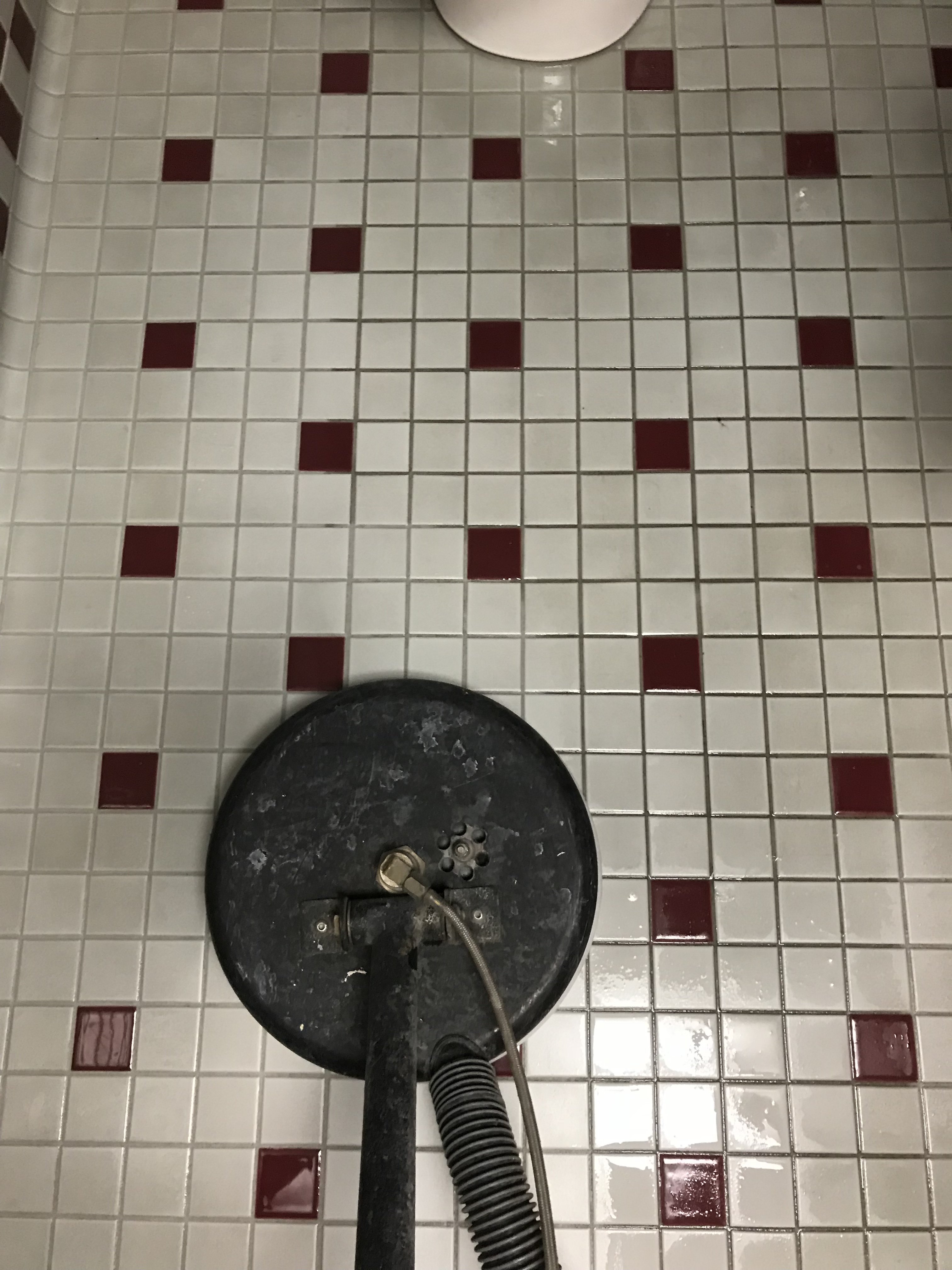

Definitely need to see the bathroom pictures. Since you are cleaning this once a year, what equipment are you running? You might be able to get the abrasive stuff in powder form which might be more cost effective but definitly not good as you dont want to breathe in that stuff. Bio clean is amazing stuff for sure but like you said, it expensive. I only use that stuff when I can charge for it.

Hi Mikey. I took a picture of the tile last time we cleaned it. This particular bathroom cleaned up pretty good, but the other 15 don’t hardly make a difference. Do you have any suggestions?

In the mean time, try Tile Strike from Soap Daddy.

Have you tried an acid????

Hard water stain remover is probably an acid.
Prochem acid cleaner is great.
I use a lot of soap daddy products too.
Never use the acid but I've had issues where the bottles leaked in transit.
And I wouldn't mess with the acid possibly leaking.
