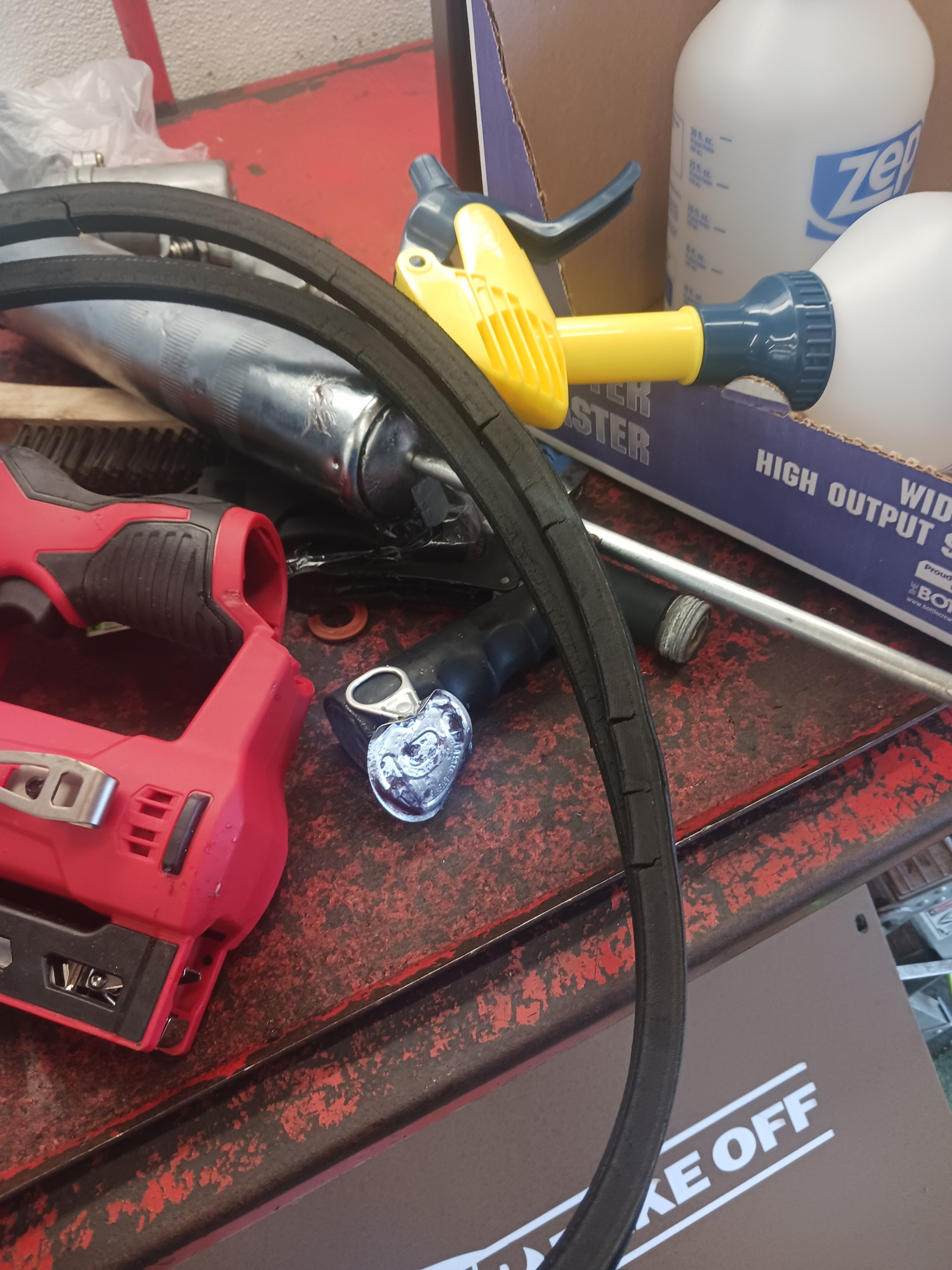

So if im doing the math right you've gone thru 5 belts in 2800 hours?? you're getting on average 560 hours on a belt?? and you feel this is good??
I feel pretty good about the number you came up with, I don't run my belt to a pulp, always remove one link when the belt is getting wobbly. Never had a broken belt!!!
When the belt is getting thinner, I toss it out and replace it with a four feet section. I went through five couplers from TB Woods. It takes less than a minute to replace the belt, for coupler replacement, I need about 10 minutes since shafts can be pulled apart with an actuary motor. I share this for comparison, I'm familiar with standard belts and the timeline for their replacement. I may be OCD about my truck mount, I over-maintain it, I'm always game for spark plug changes, oil changes for a water pump, blower, and the engine as needed, and even more often. I'm proud that I'm one lucky bastard that spends zero hours and zero dollars in repair facilities. I believe that almost 600 hours doesn't sound bad at all.
