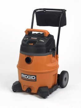

HD's Rigid brand are the best.
Buy the $159 dollar one and it's also one of the quietest on market

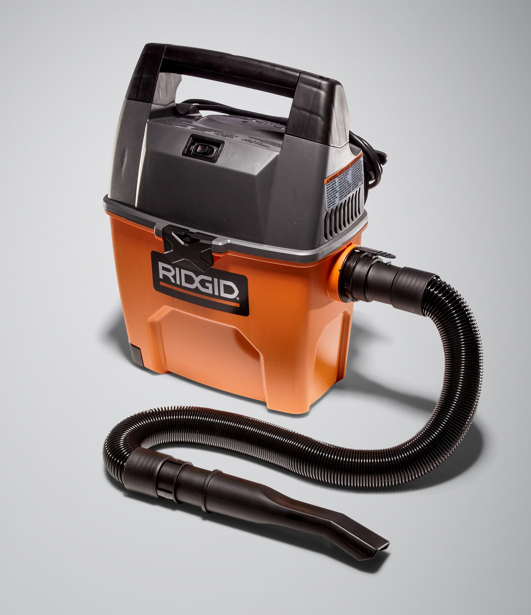

a light wt small one in hand is handy to have too for some tasks
this one kicks azz and is only $39 right now

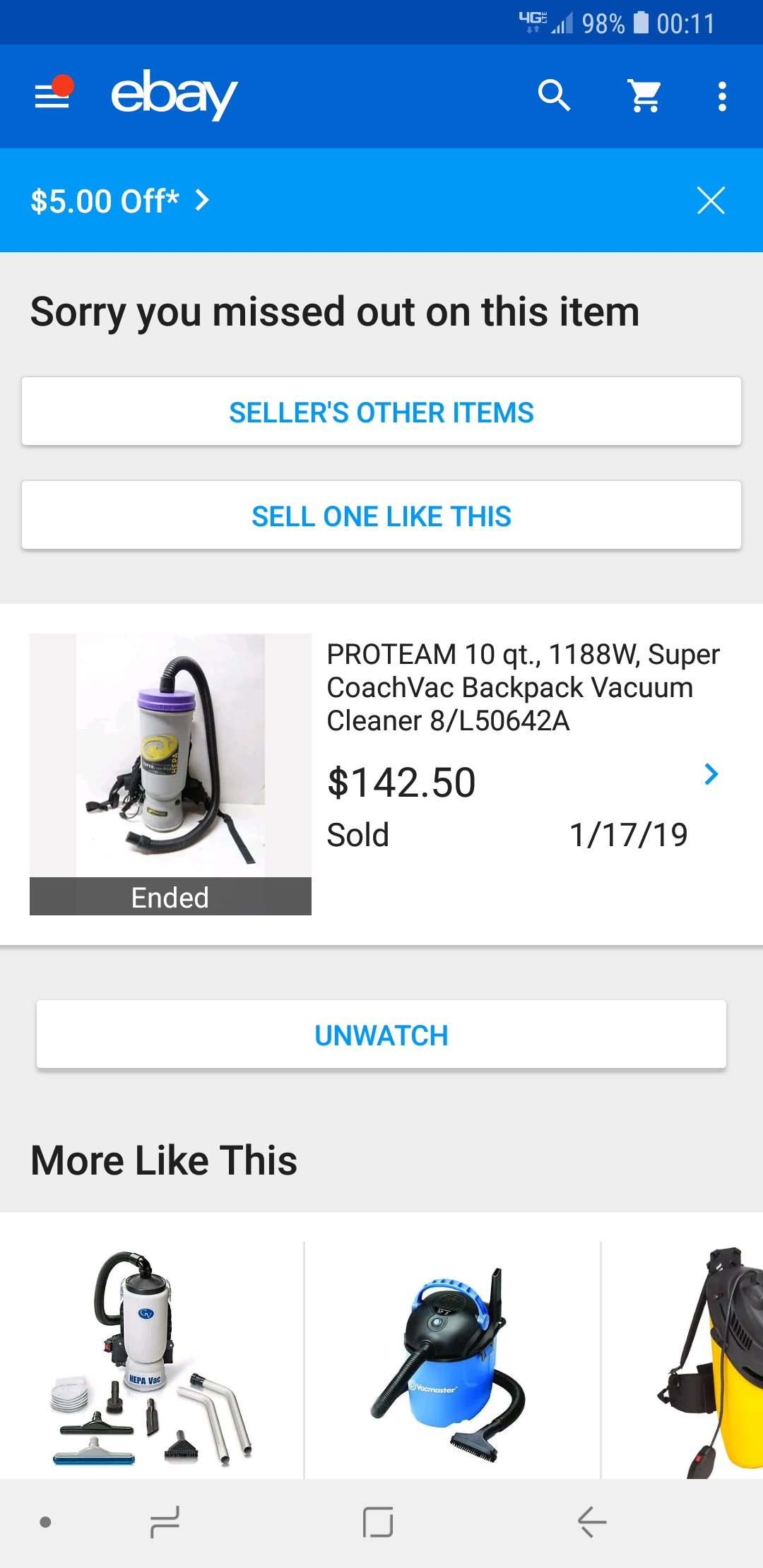

A planet far far away
This a nice one too. We got one from an MB auction.
