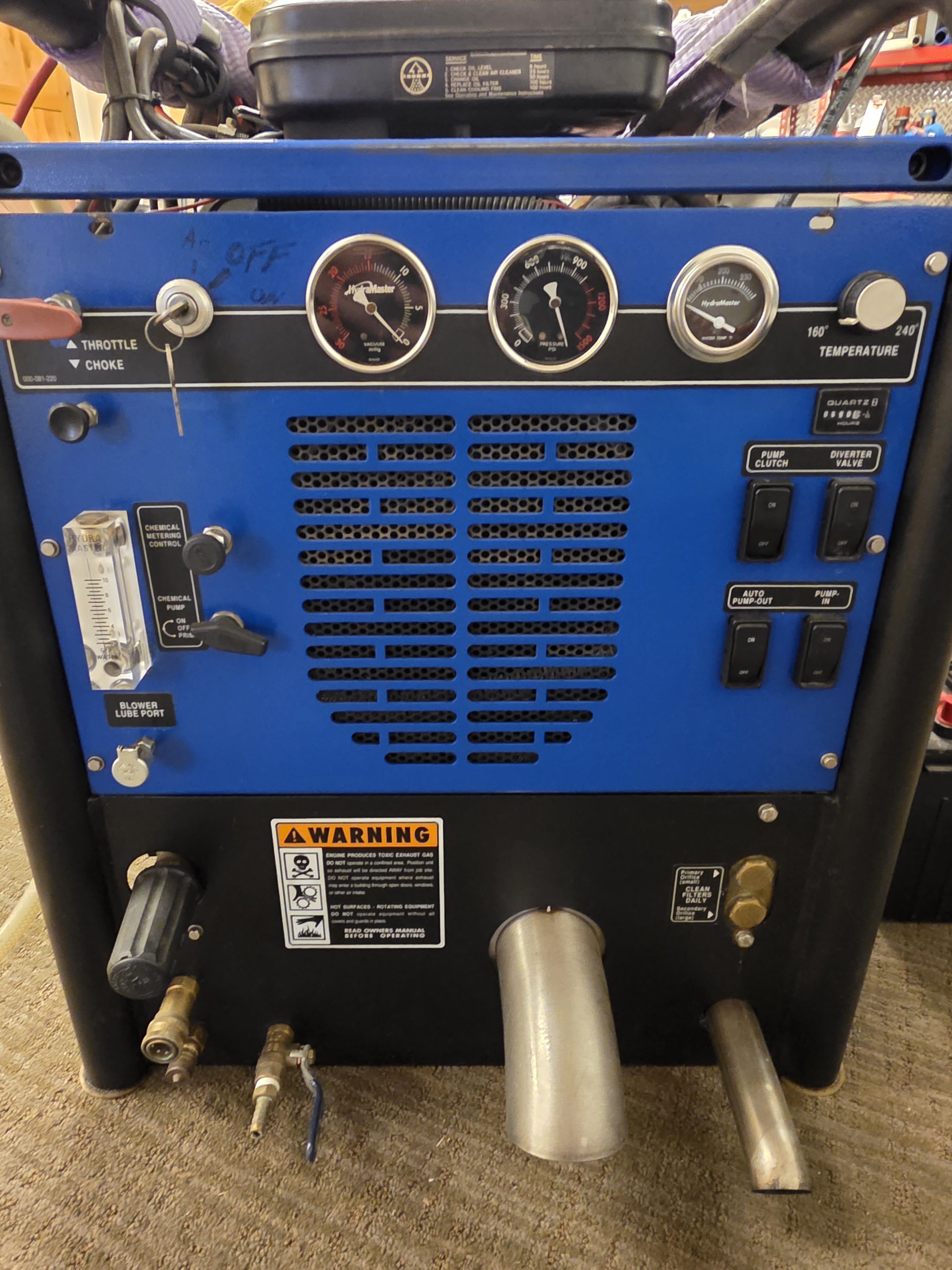

I recently purchased a used van and truckmount setup with a Boxxer 421. The previous owner apparently never winterized it, and it looks like a few elbows on the heat exchanger are burst.
I’m fairly confident I can repair the heat exchanger, but this will be my first time digging into a 421. I also own a 427, so I’m somewhat familiar with the Boxxer line, but the 421 is laid out a little differently.
From what I can see, it looks like the blower heat exchanger may need to be dropped out from the bottom. Is that the best way to remove it, or is there a better approach?
I’m also curious if there are any other known weak points on the 421 that are worth addressing while I’m in there, or any worthwhile upgrades people recommend.
If the heat exchanger ends up being a total loss, I may just convert it over to a Little Giant setup.
Any input on removal, repairs, common problem areas, or worthwhile upgrades would be greatly appreciated.

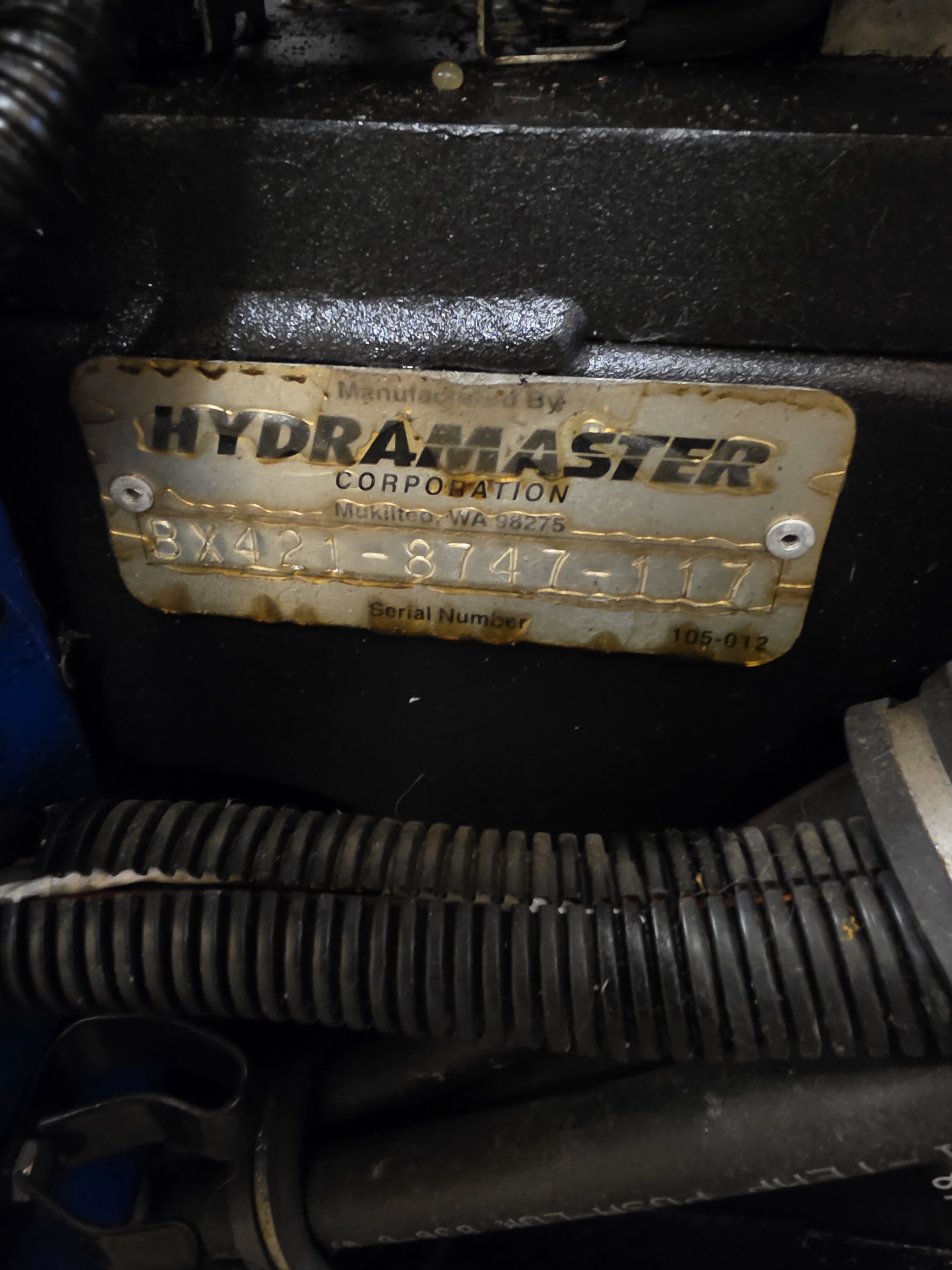

Do you know what specific year model that boxer is? I think they have several different designs. And if that's a Briggs engine, you'll need to get the valves on the engine checked. I think that's a 300hr service.

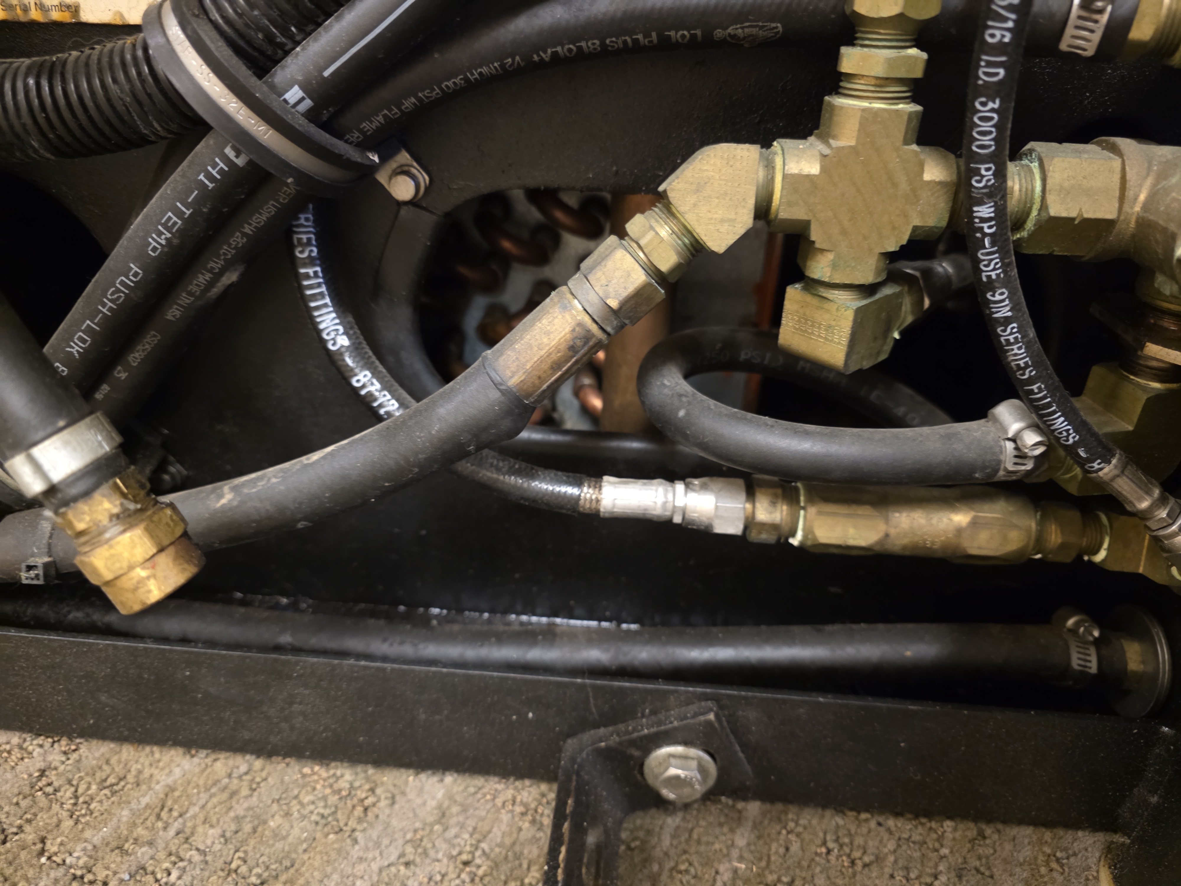

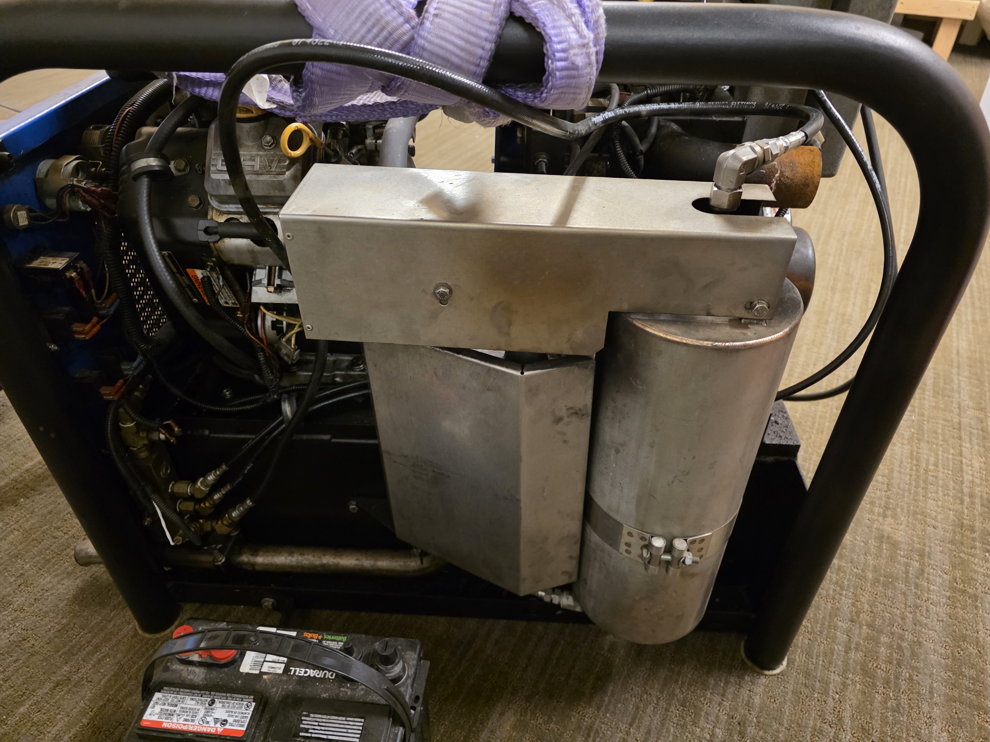

AI is thinking it may be a 2007 model. It shows 690 hours, but I was told a big portion of those may not be actual run time. Apparently if the key is left on, the hour meter continues to count, so they estimated maybe 70% of those hours came from that.
This machine has the stainless steel exhaust style heat exchanger, along with the blower heat exchanger that uses the copper style core.
From what I can see, it looks like dropping it out the bottom is really the only option. My plan is to set the machine on a makeshift wood table, cut an opening in it, and drop the heat exchanger out that way rather than trying to do the job while the unit is hoisted up with my Bobcat.
The Boxxer 427 gets a bad rap from some people, but mine has been excellent. It has also been a whole lot easier to work on than this 421. 20260330_192116.jpg20260330_192137.jpg20260330_192153.jpg20260330_192857.jpg

That one looks pretty good. Two other things you may want to check are the potentiometer / thermostat for the temp control and the hose at the top of the engine exhaust heat exchanger, we've always had problems with them. We keep a spare in the van.
