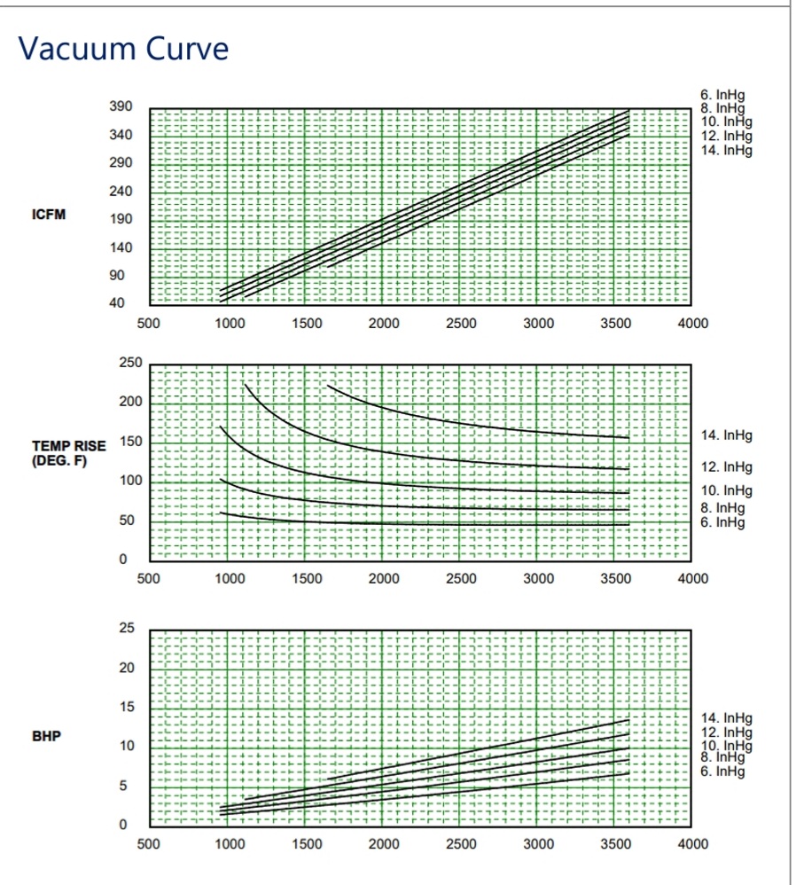

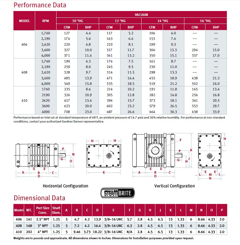

I’m hoping to learn the factory set RPMs of the blowers (and engines) on the Prochem 370, Peak 500 (same blower as the 370 but better air flow) and the 650.
Can any of the three be spun slightly faster through engine speed or pulley changes to increase airflow, preferably without causing long or short term damage to any of the components?
