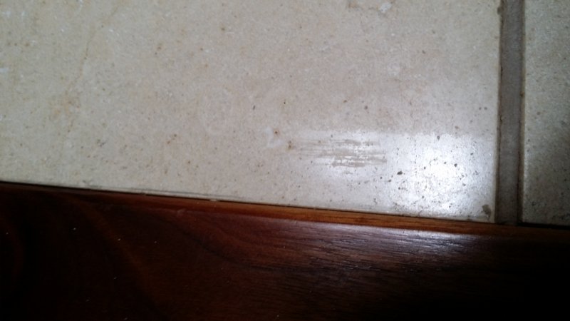

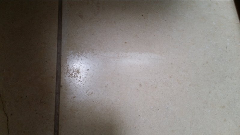

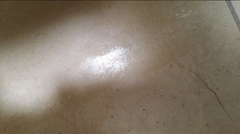

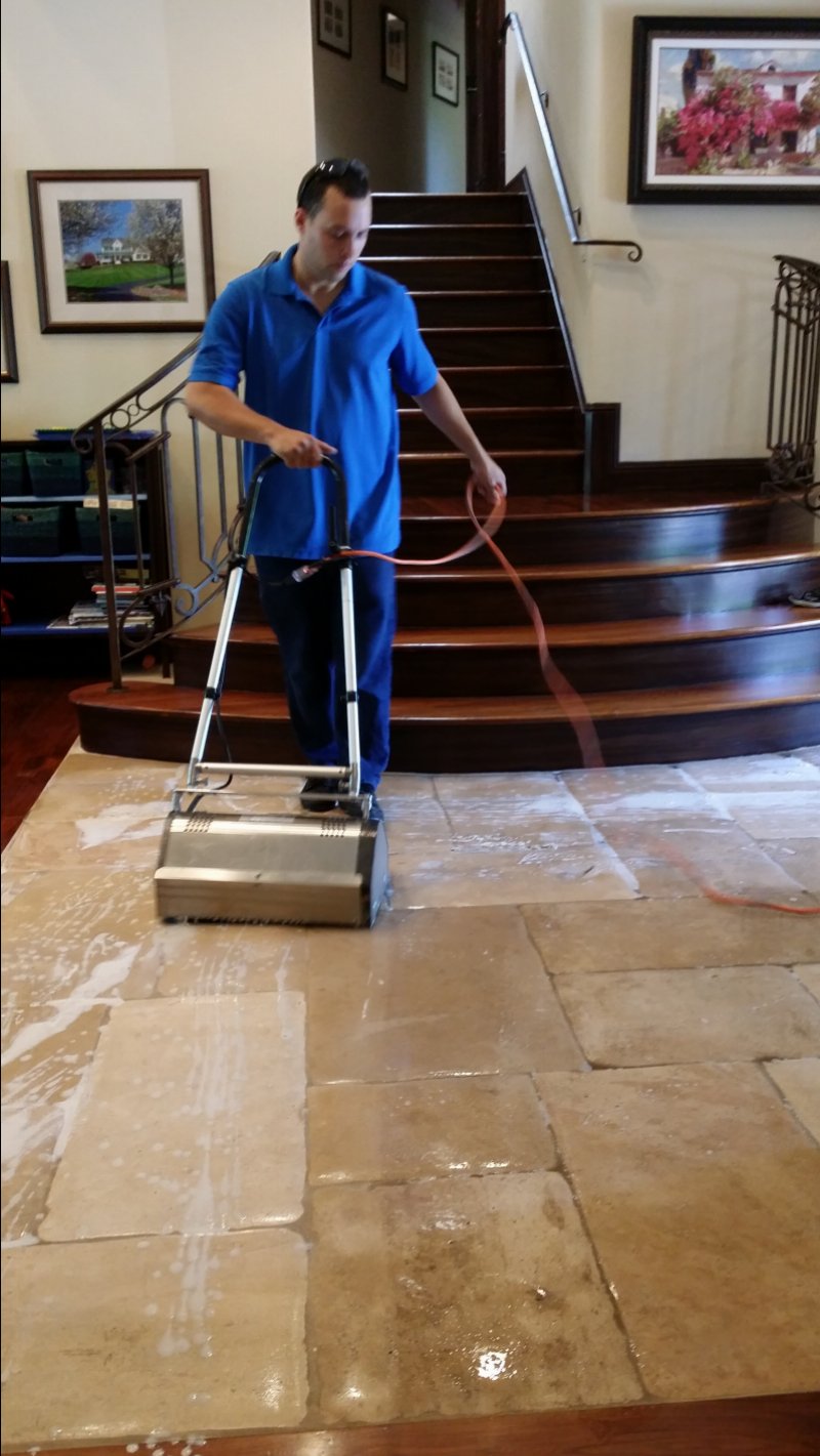

big ol'job today.
3 rooms of wool wtw. 3 sofas, 4 chairs, 2 ottos all fancy but clean fabrics. 3 bath room floors of limestone and marble, marble kitchen and an even bigger pillow edge limestone entry
One bathroom and the entry had a topical on it that none of us could see. No shine in the grout at all, but the flex and turbo busted enough of the mopNglow or water based Glaze and Seal off that we were on the hook to get the rest off...
a good three hours wasted but still a nice $2647 pay day.

are those 3 pics of the sealer before or after.
People that slop sealer on limestone are dipshits to begin with. Usually you can find telltale signs in the door jambs. Look along walls or right next to the jambs and you'll usually see streak marks.

We used a black 3M pad..
Do you mean dry?
No way.
Pad would gum up, you'd scratch the stone, grout would go untouched as woukd the valleys in that stone
Wood went unharmed.
B
Bee Busy
You are lucky the wood went unharmed looking at those pics....tape them up with 3M Blue tape then tape over with Scotch Blue Pre Taped painters Plastic with beach towels over just in case...yikes!!
117,312
I'd rather have a guy with a towel right on it.
Stripper gets under that tape and it will sit and destroy for the hour or more it's hiding.
