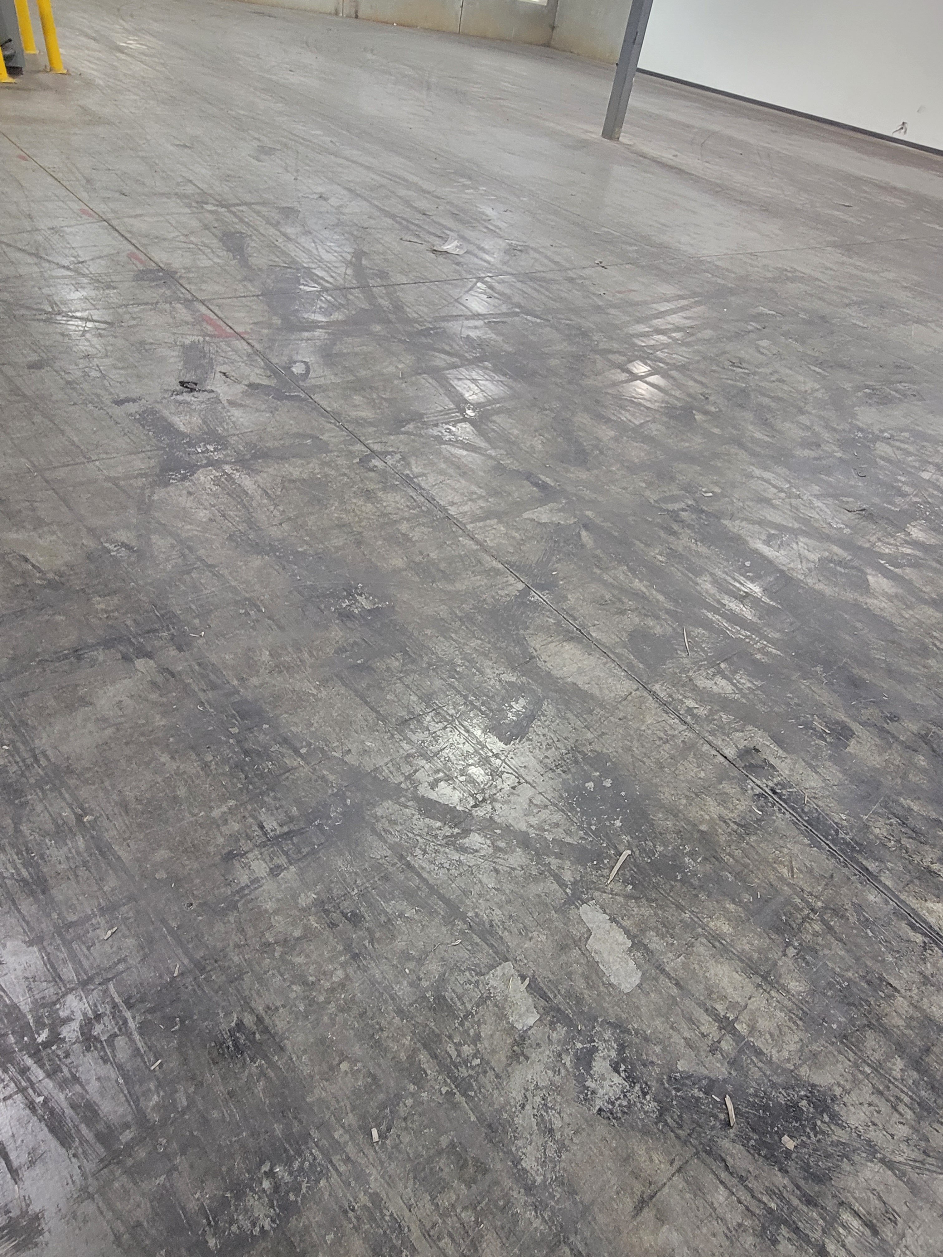

So my boss got a job cleaning a sealed concrete warehouse, we have never cleaned concrete before but we have cleaned other hard surfaces. So I was wondering whats the best way to clean off forklift tire marks, any help would be appreciated! Have picture attached for reference 20211027_170917.jpg

your pic looks like it has failing paint, I dont think you be able to clean it, need to grind it off.

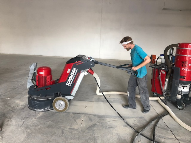

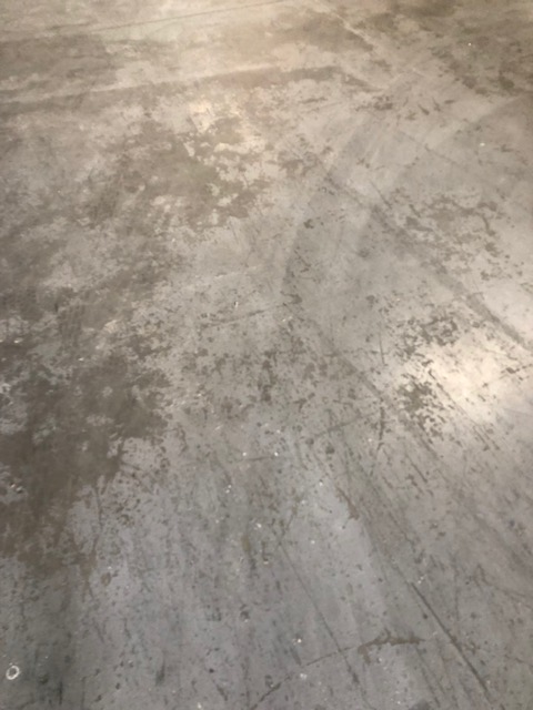

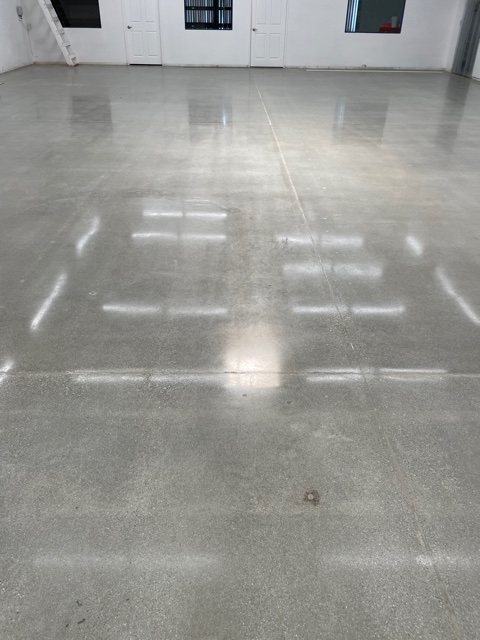

Todd Slamen
8000 sf building it was with failing epoxy, ground off start 16, 40, 80 metals, 100 transitional, 100 resins, denify, 200 -1500 guard and burnish
