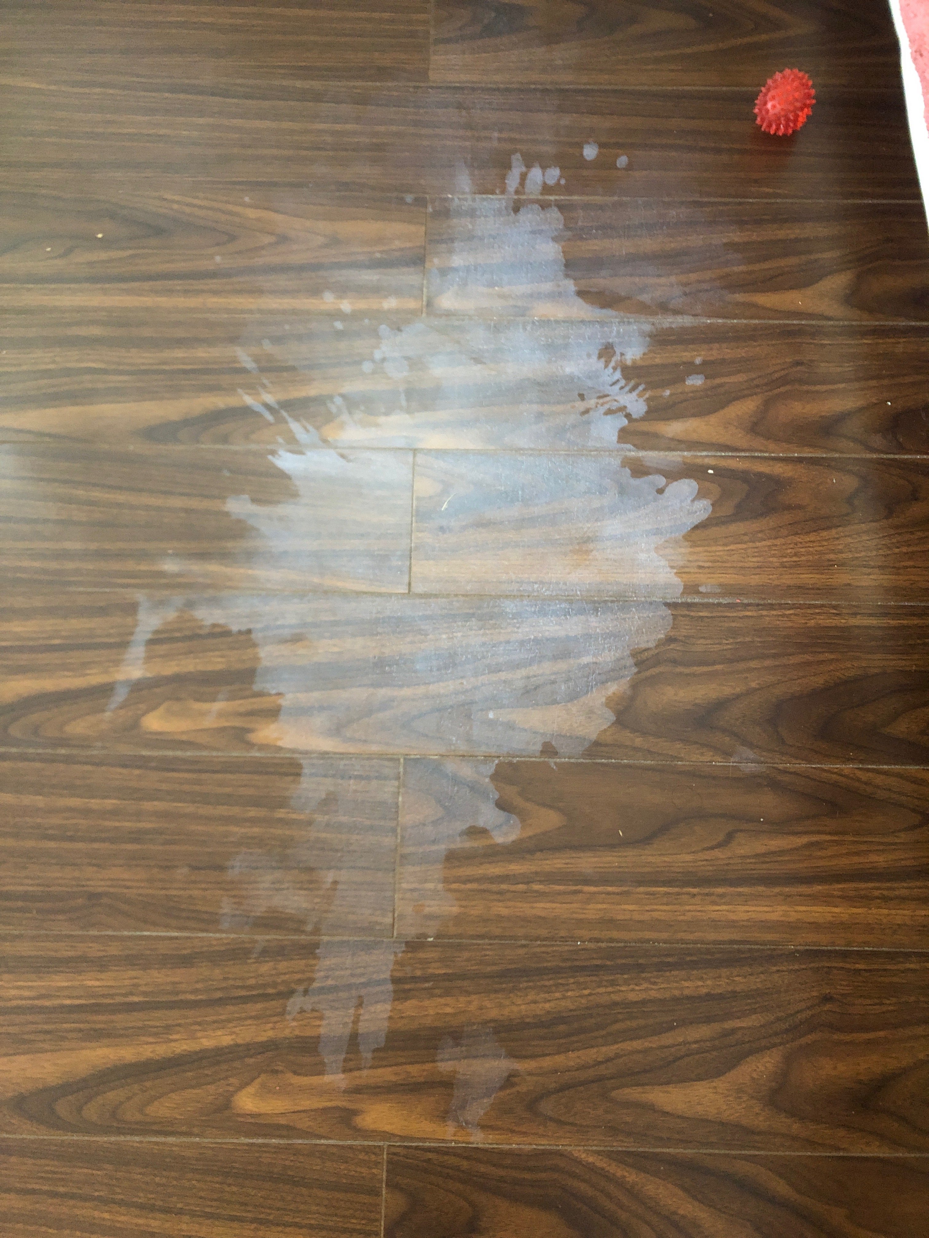

My first question is to know what kind of stain is this and what is the best technique/product to remove it
Thanks
some type of solvent (nail polish remover) spill?
idk
/off to ban Canadians and Steve from this thread
is it "real" wood or some kind of plastic/vinyl??
does it mostly disappear when wet ?
or still obvious?

Looks like something that damaged the factory wear layer
Jimmy L
15,253
Jimmy L
Looks like a wax spill
Poly urethane floor wax
If it shows under a black light that is what it is

It it difficult to tell if that is a coating of something or the damage caused by something. Here is what I would do:
1. Assure the customer that the floor may be badly damaged, needing sections replaced. You are to be paid for trying, however it results.
NOTE: Do the following in the middle of the stain, to prevent an accusation that you made a bigger, worse spot.
2: Using denatured alcohol and a microfiber towel, see if you can remove the stain. Alcohol will not damage the finish, but it will dissolve water based paints. Scrub hard and watch closely.
3. If step 2 didn’t work, use a “Magic Eraser” (https://www.mrclean.com/en-us/shop-products/magic-erasers/magic-eraser-original) and water to scrub an area. Magic Eraser will not damage the finish, but it is an ultra fine abrasive and works wonders. It may or may not get into the grain pattern, so just see what happens.
If 3 did not help, you have a chemical burn of the original finish. Consult with a local flooring store to see what replacement would cost and add a percentage to that fee for your time. Then, let them do the work.
Good luck!
117,272
it is a laminated floor
The top layer of the product is plastic over a photograph.
Either a particle board or plywood core or my guess, it's actually porcelain..
Try all of Coasties recommendations but I think I'd start with either vinegar or ammonia 1st.

Is there a floor vent that you could pull up and look at see the inside of this floor to show us what it's made of?
and what kind of half assed wood worker are you?, anyways...
not a plastic one

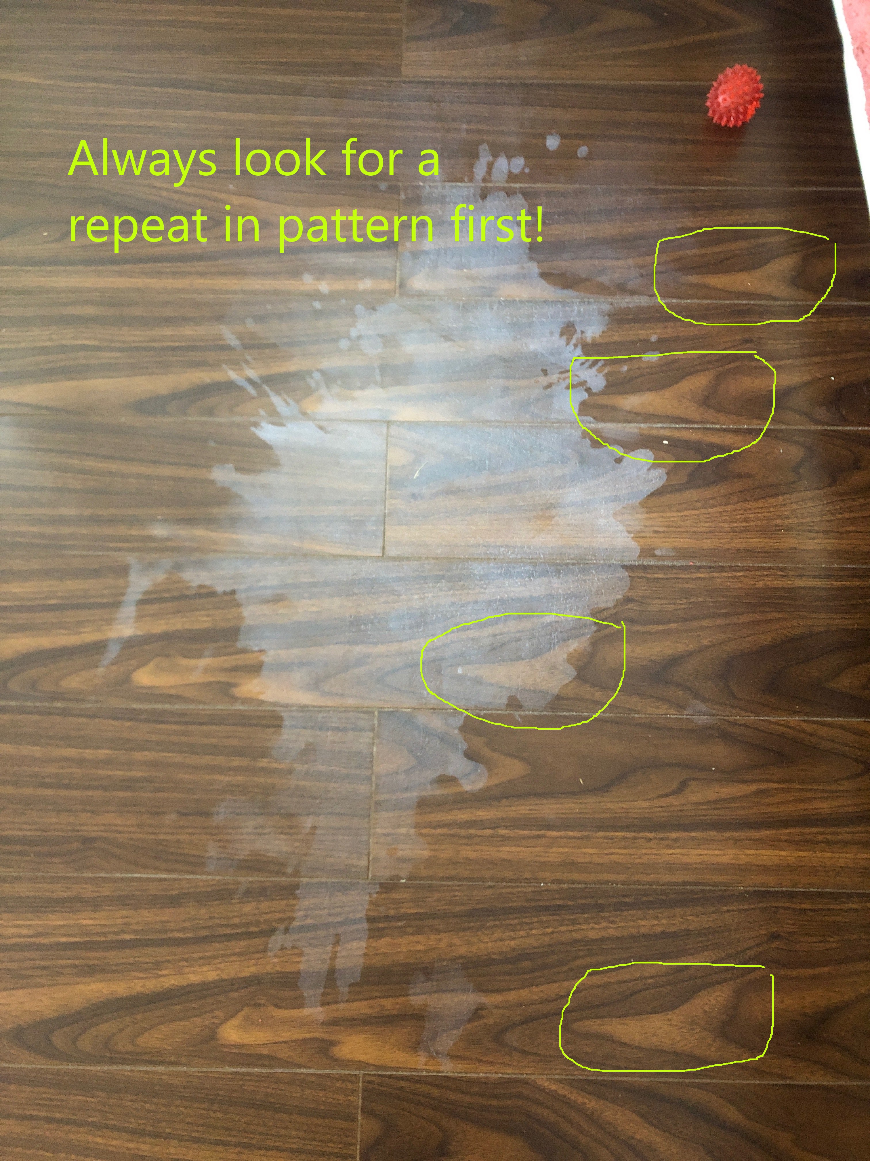

looks like the grain is repeating = fake chit
if it disappears or nearly when wetted out, something ate the finish off .
re-apply some satin poly
if it's plastic wood, floor finish
if no difference when wet, it's fooked whether wood or plastic .
cause if wood, the veneer top is too thin to sand it out.
if plastic , can't do chit period
replace the bad pieces if same product is available...or buy a throw rug....

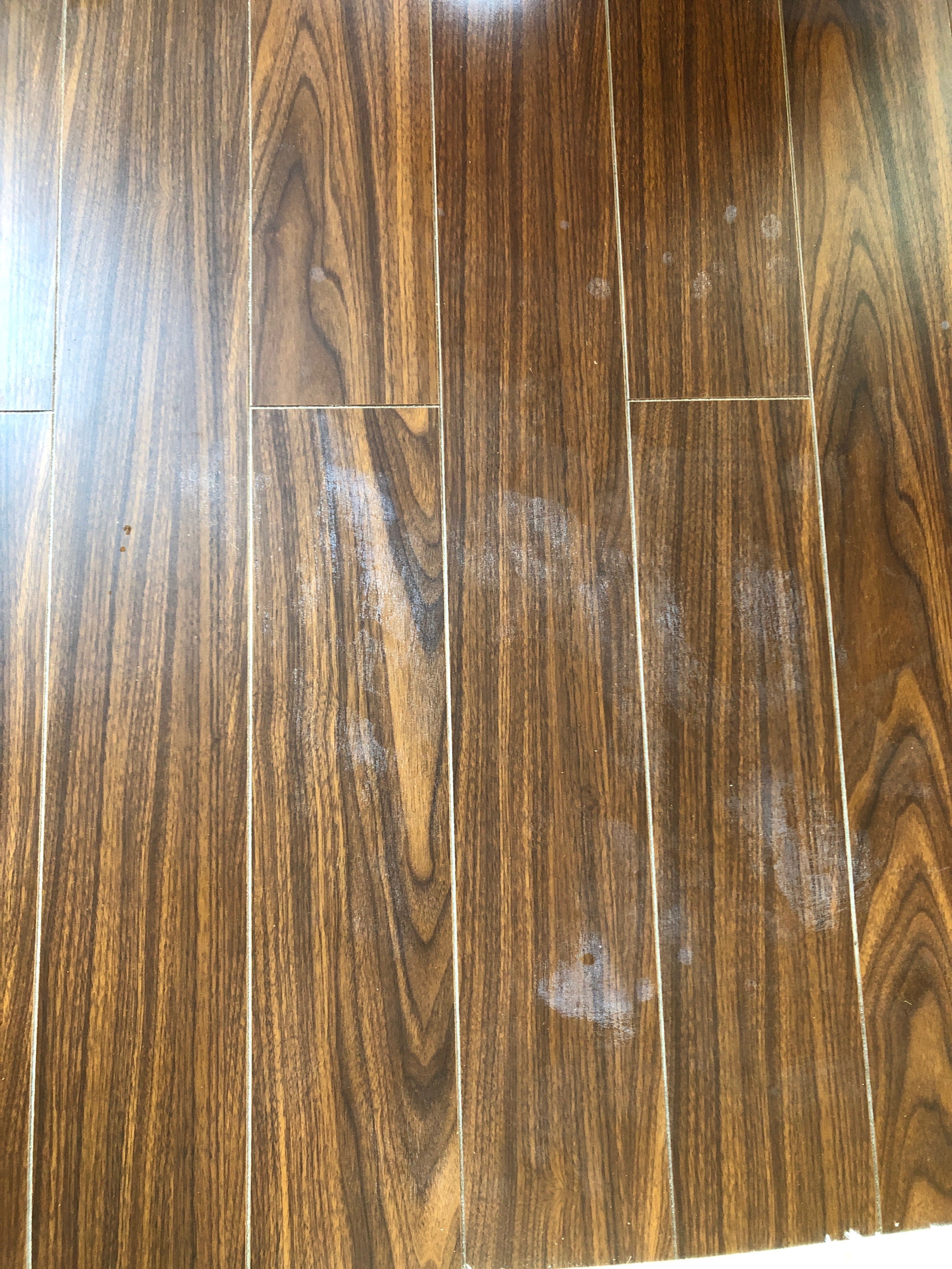

That's what your carpet cleaning detergent looks like if you spill on a hard surface. Might just need to be cleaned off of the surface.
looks like white grout between porcelain planks in the lower photo
I thought so too. A plastic plank copy of a tile that is a copy of wood?
Doug Rice
Feb 28, 2011
425
Ask the customer if they have some of the product remaining that you can test. It is surprising that many say they don't know what it is until you ask for a sample. I would just use a neutral cleaner and lightly scrub but keep a towel nearby to keep it dry after scrubbing.
