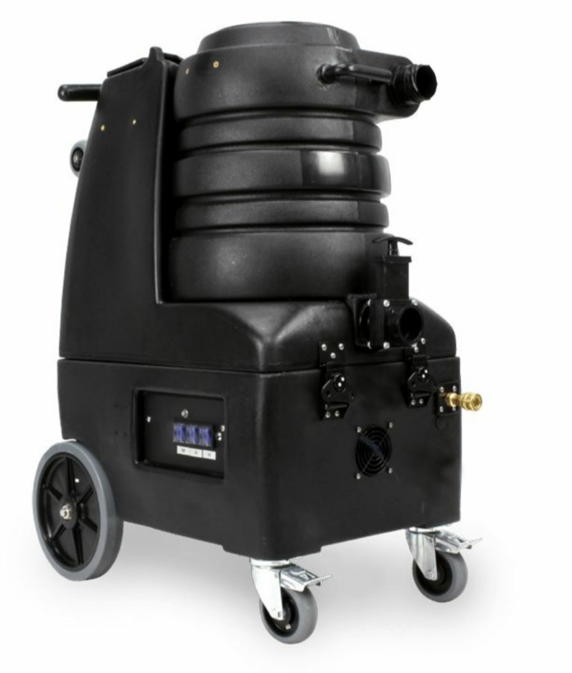

John Stewart
The Nautilus will be sorta easy to get into your van since it is longer. simply tilt the port to place the front wheels onto the van floor. then lift the back end onto your knee and toss it in to the van.-- however this design will make it dangerous to bring up or down the stairs.
Or buy ramps.
