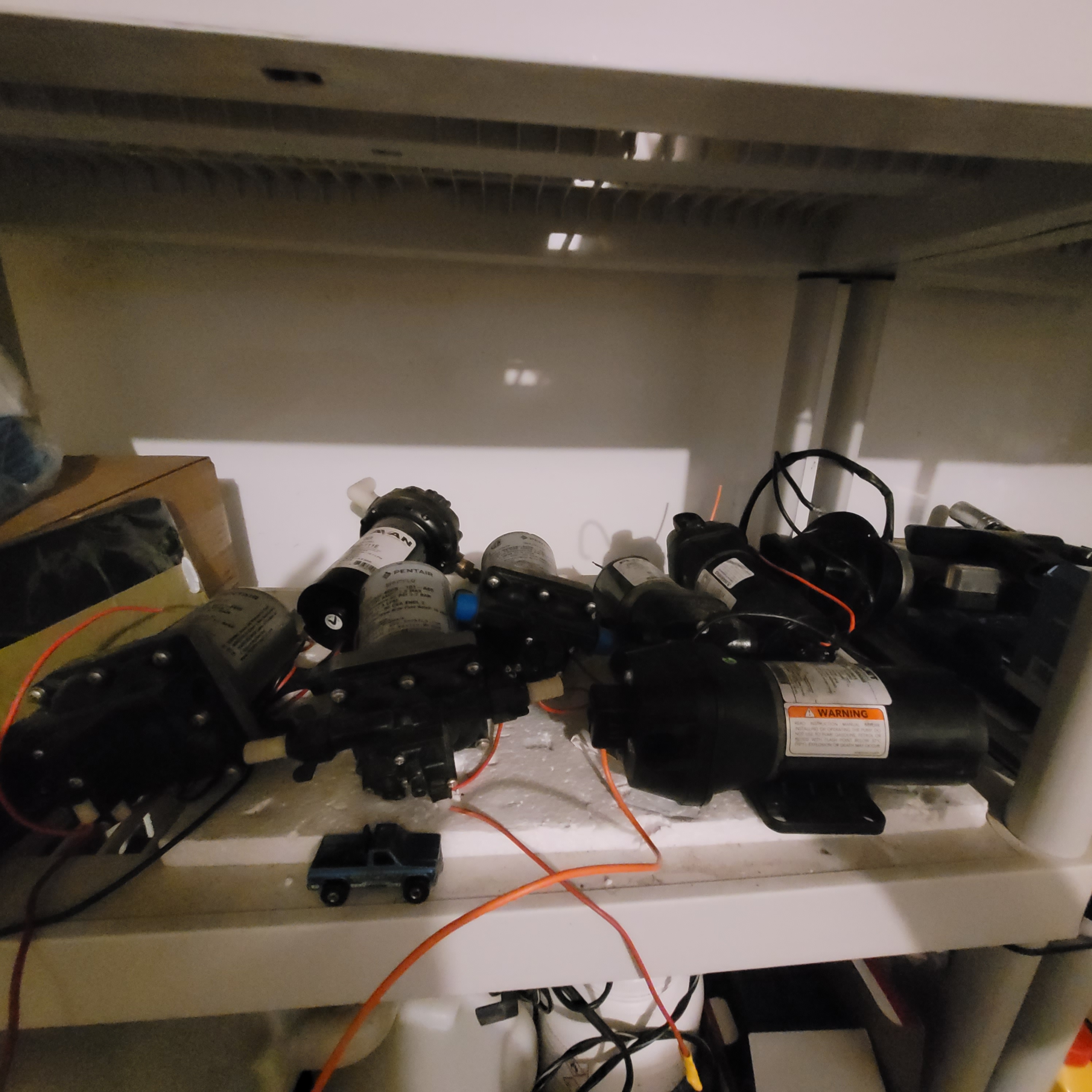

I had transfer pumps from ShurFlo, Flojet .I believe that Flojet is a better brand with more resilience compared to the other brands. Thank you for your continuous contribution and commitment to our community @Jim Pemberton

The " grave " of transfer pumps. One of them is a Delavan by Powerflo, bought by mistake ( 70 psi)
