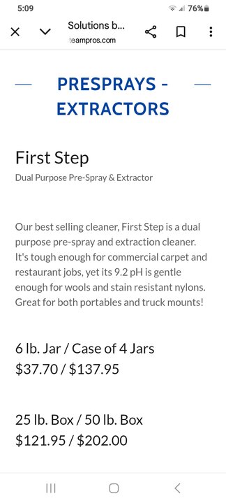

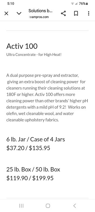

I have used hd100 from soulitions by steam pros as my emulsifier and first step as my prespray for about 25 years now and love it i buy it by the 50lb box and when i buy 2 i get a 25lb box of my choice free to offset some of the shipping i generally buy 200lbs assorted at one time and get a 50lb box free 250 lbs of powder generally lasts me about 8 to 10 months
View attachment 133414 View attachment 133415 View attachment 133416
Bane , Heat is below 180'

That's a good price !!!!
So is mine. I use a pto so water to water heat exchangers only get to around 180° the salsa afterburner on frankinstien will bring an additional 15°. And will hold 180 cleaning. But ive only had Frankenstein for 3 years now prior to that my machine (spare machine now) would get to 170 - 175° and hold about 160° cleaning ive been using those chems for at least 25 years
