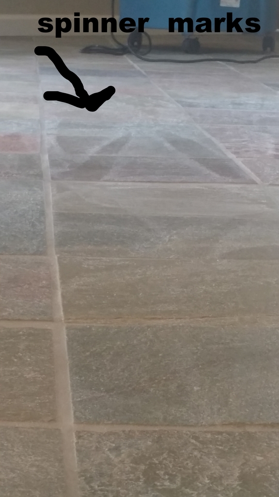

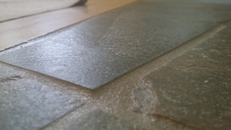

I messed up and gave a quote a couple weeks back and due to my gimp like state, I didn't get on my hands and knees to check a slate floor..
Bit my guys in the ass today. Hours wasted.
Got off easy due it being just one coat of water base...the spinner streaked it all to hell so stripper and black padded it to almost near good enough. Very understanding home owner.

My guys spotted what I didnt. They called and asked what to do..
Usually a toned down cleaning will get it clean with out bothering the coating.
But the a mild 600 psi and neutral chems blistered it so they had to strip..
They would have walked had I not pre bid it.

How would you have been able to tell that there was a coating of finish on it beforehand?
117,353
The artificial shine.
It sometimes takes the ability to get your bucket head a few inches of the floor.
Which aint easy on crutches.

Always spot check stone with a acid and a alkaline.
If you spot checked the alkaline would dull the finish. You can't dull stone with an alkaline no mater what stone it is. Unless you come across floor finish.
