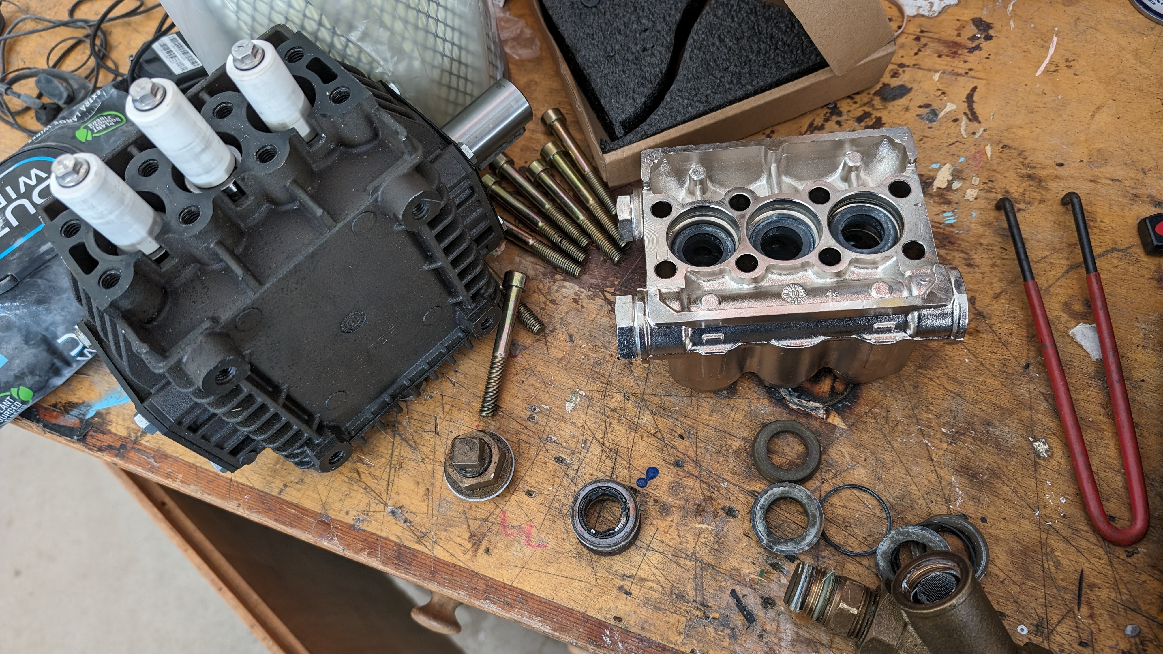

Well, I got my new pump today for the 870. That thing is BIG. I'm paying a guy to install it, I just don't have the time to do it, and I don't want too.
I'm dreading the day my pump will need some major surgery or replaced too. It's not located in a friendly spot on my Everest
