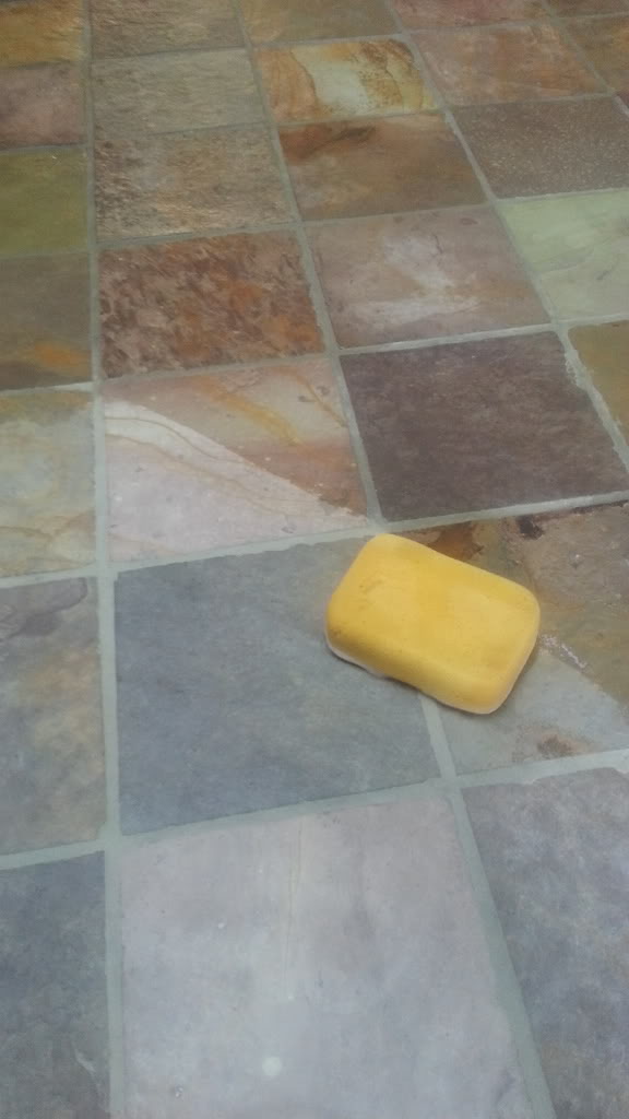

grout and concrete is not suppose to be shiny!!!
(grout and concrete is not suppose to be shiny)
So don't use ammonia based cleaners and high pressure unless you enjoy working for free.
there is a reason you don't clean tile, stone or concrete for .30 a foot.
Malgrit and or a Black pad with lots of Zep Stripper will get you out of the pending lawsuit..
