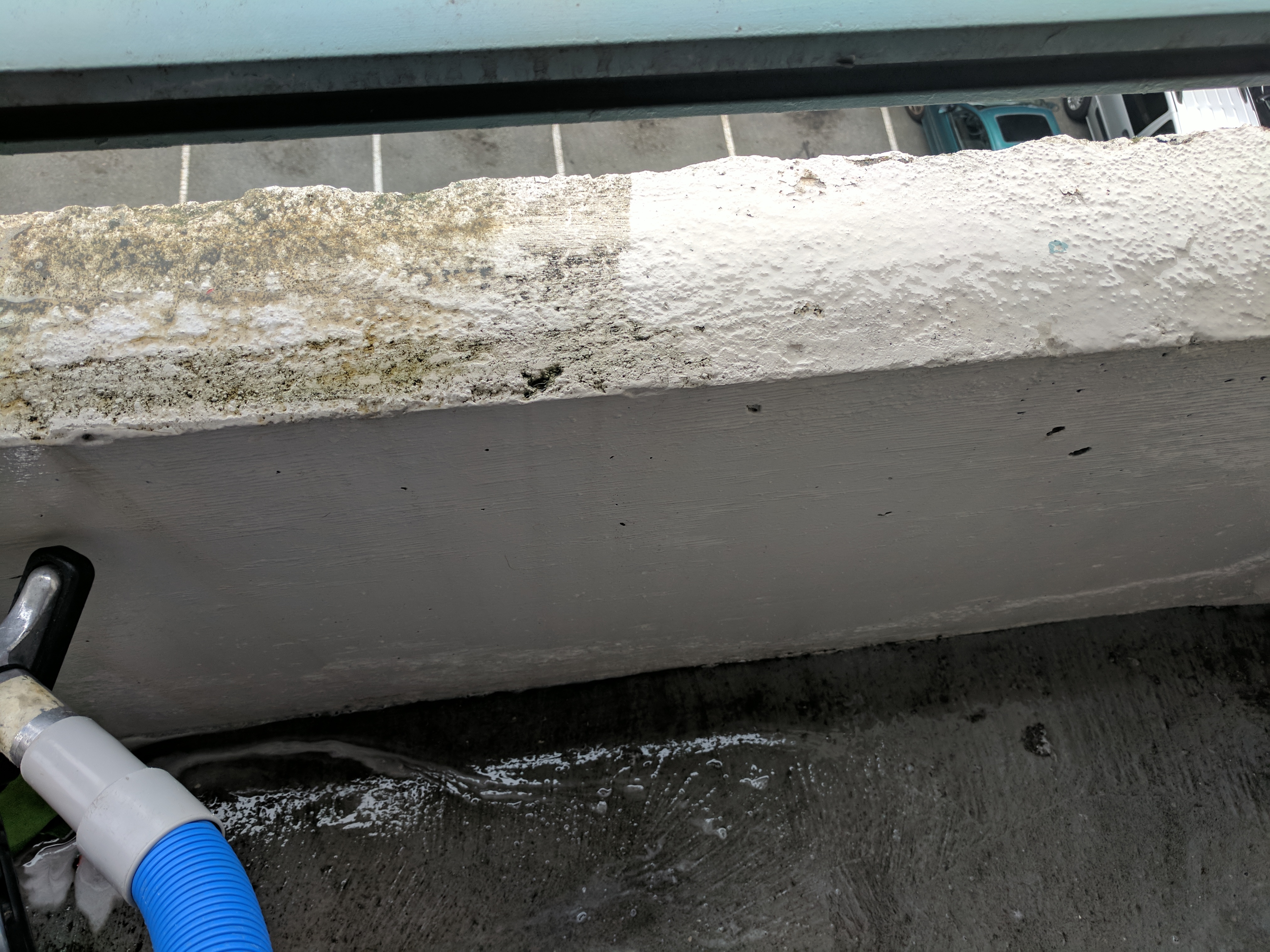

Here is another use for your hard surface cleaning equipment. These are concrete balconies that can't be power washed due to the over spray. We block the drains and clean with a 1200 psi pump, old ninja for vacuum and an assortment of floor and hand tools. This particular one I presprayed with code Red, wire brushed a bit and rinsed with procyon.
