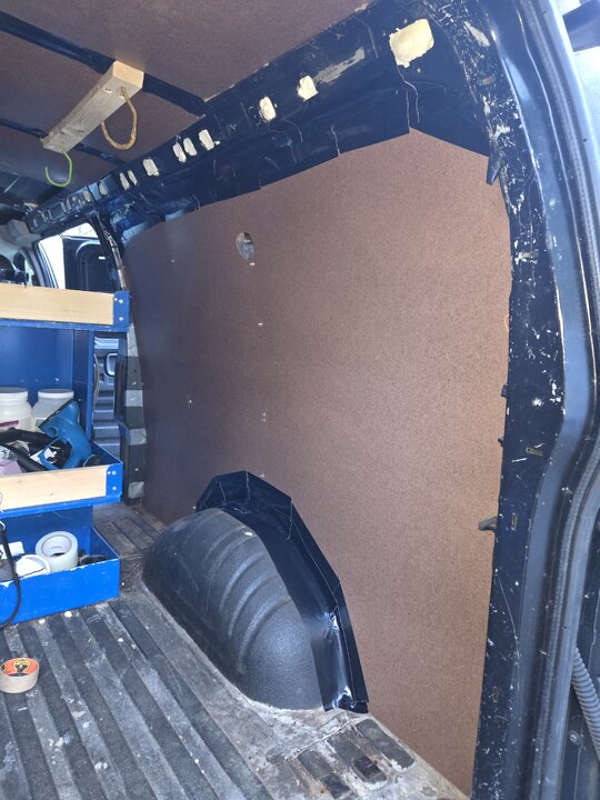

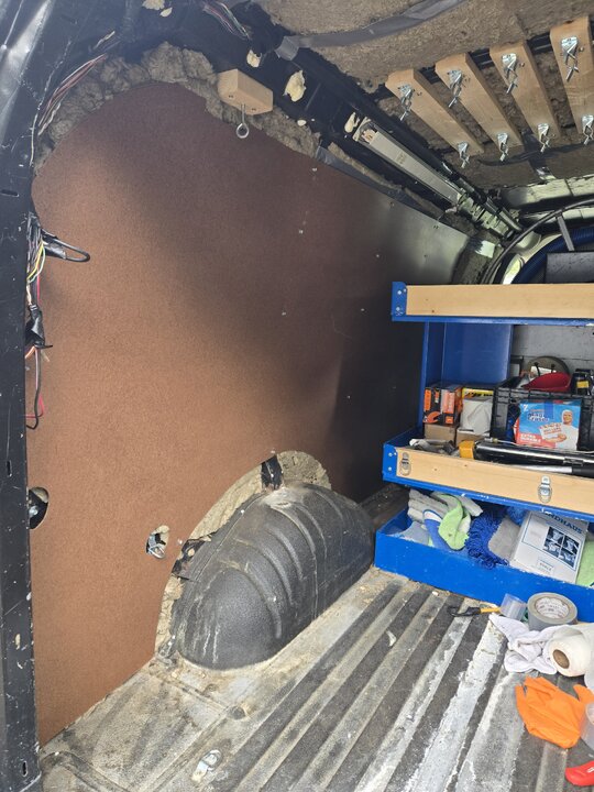

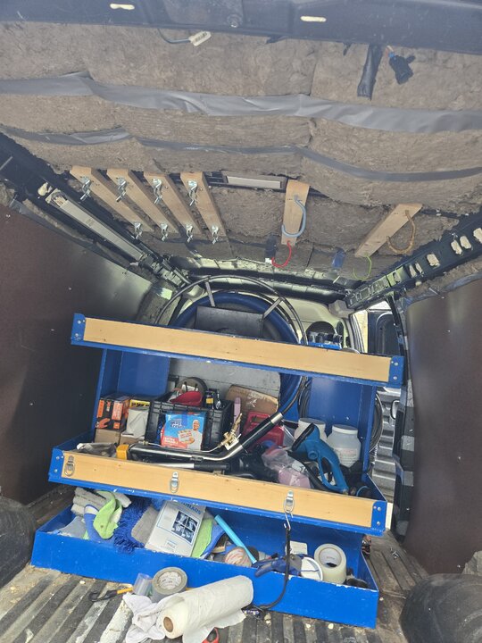

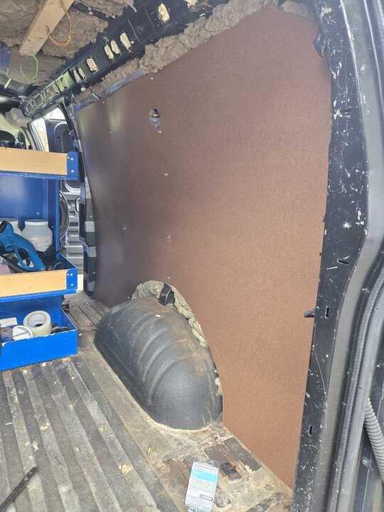

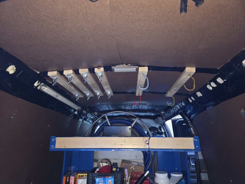

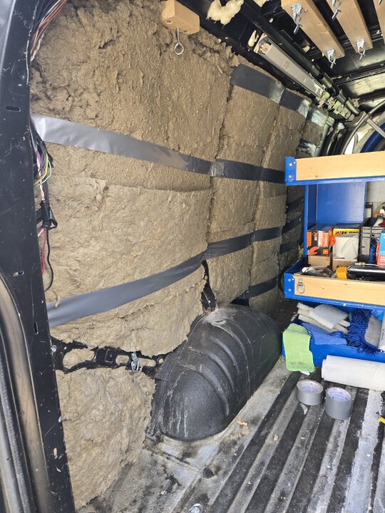

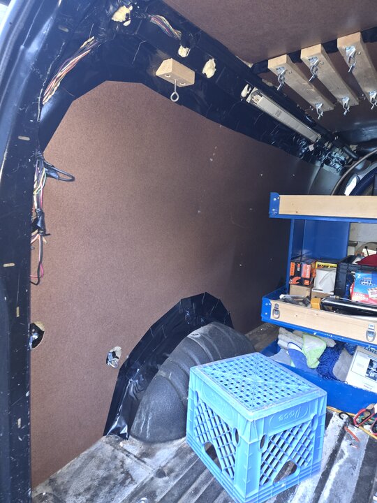

I'm going with rockwool batt insulation covered with masonite screwed into the sheet metal ribs. I think it will look nice, and it is a great insulator. The rockwool is less susceptible to moisture problems than fiberglass. I'll seal all the sheet metal ribs or whatever they are called with expanding foam, and test the roof ones first to ensure they dont push the exterior sheet metal outwards and make it look weird.

This took me all weekend. Everything takes a long time. There are 2 more sections to do over the waste tank, and I will do this to parts of the doors too. I think it came out good enough. Thanks for saying something about how awful the insulation would look Woody. Thinking about covering it from the beginning helped it all come together. This thing will be toasty warm!

I hope not. Rock wool insulation is more resistant to mold growth than fiberglass insulation is. They say it is hydrophobic and resists moisture as well 🤞

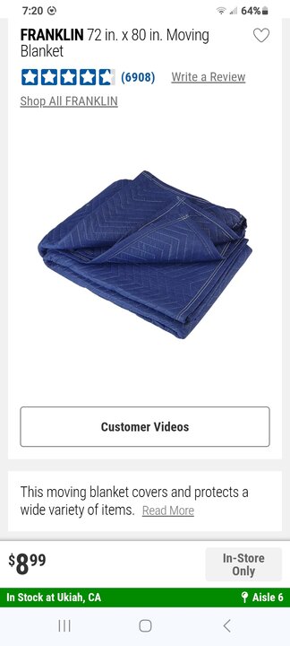

If you're going to use blankets, consider moving blankets they are really thick snd are 6'×6¾' harbor has um for 9 bucks each
