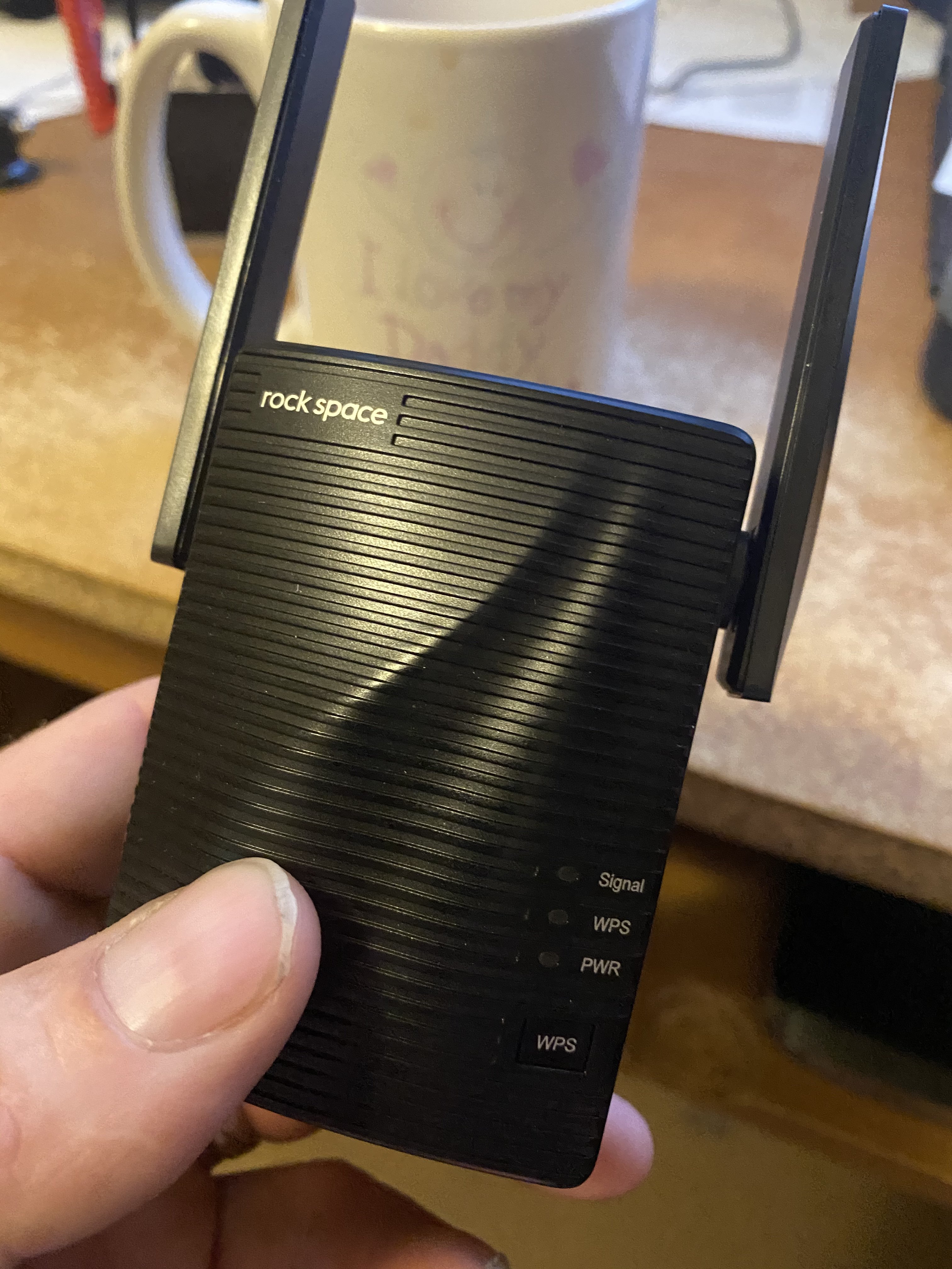

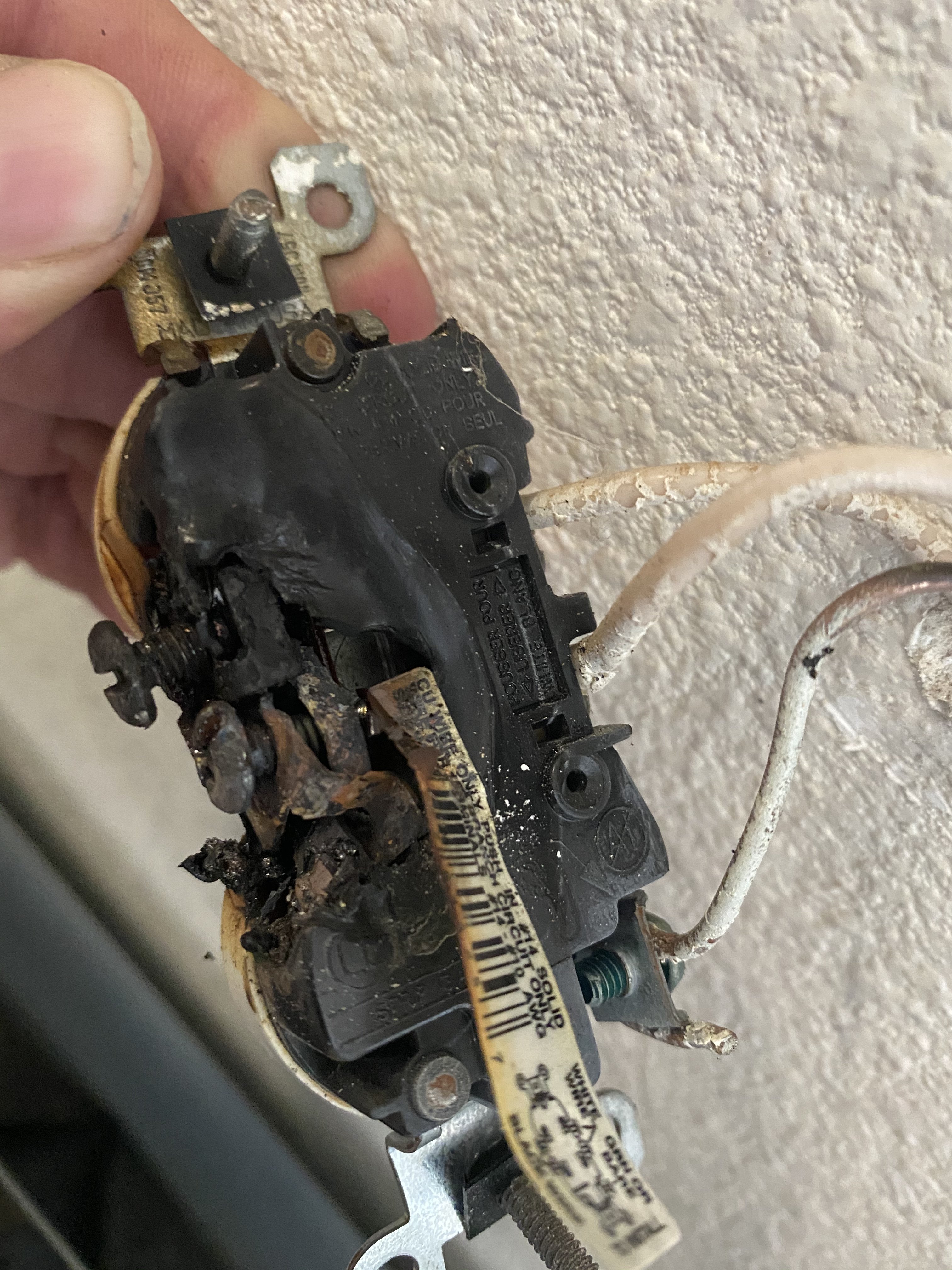

I tried to log into one of my security cameras but couldn’t because the wifi extender was not working. I figured that the fans I was using to dry my rugs tripped the breaker.
Drove to the shop to check on things and discovered my wifi extender had melted and the plug had shorted out. Very scary. I’m lucky my entire shop didn’t burn down.

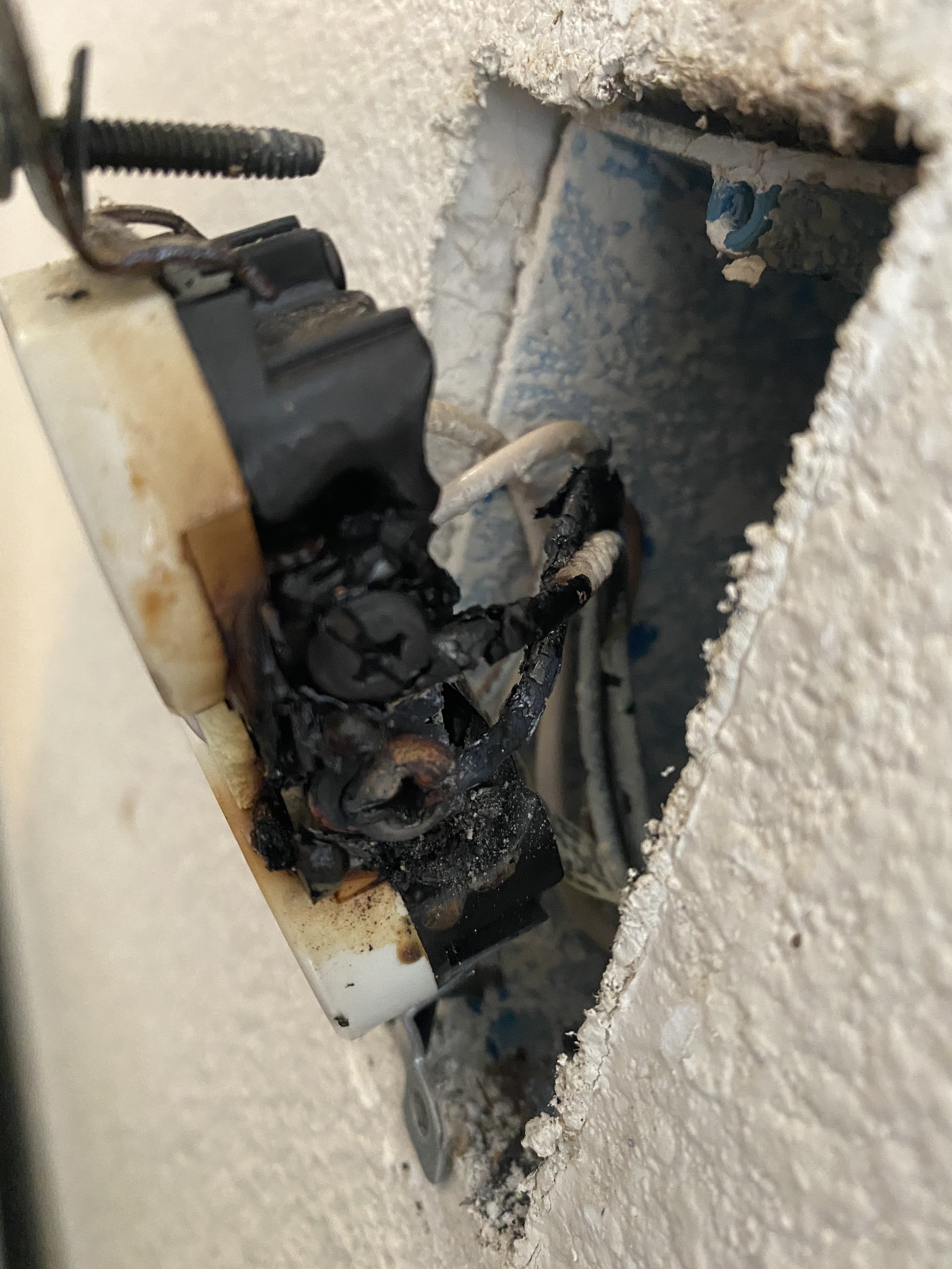

Lucky. Had a similar thing happen to me In an old house I was living in. It was a Sunday afternoon, I was watching an afternoon movie.... I started to smell burnt electrical. Naturally, I thought it was something to do with my TV, or electronics.
After searching everything around the entertainment system, I followed my nose to a wall outlet right beside my couch. When I pulled the couch away from the wall, I saw a small puff of smoke come from the outlet.
quickly, I turned the breaker off, and grabbed a screw driver. When I pulled the cover screw off, I grabbed it with my fingers, and burned myself...
When I opened it, the outlet was so hot, I had to use an oven mitt to remove it....
I bet if I was working that day, it would have burnt down the house....

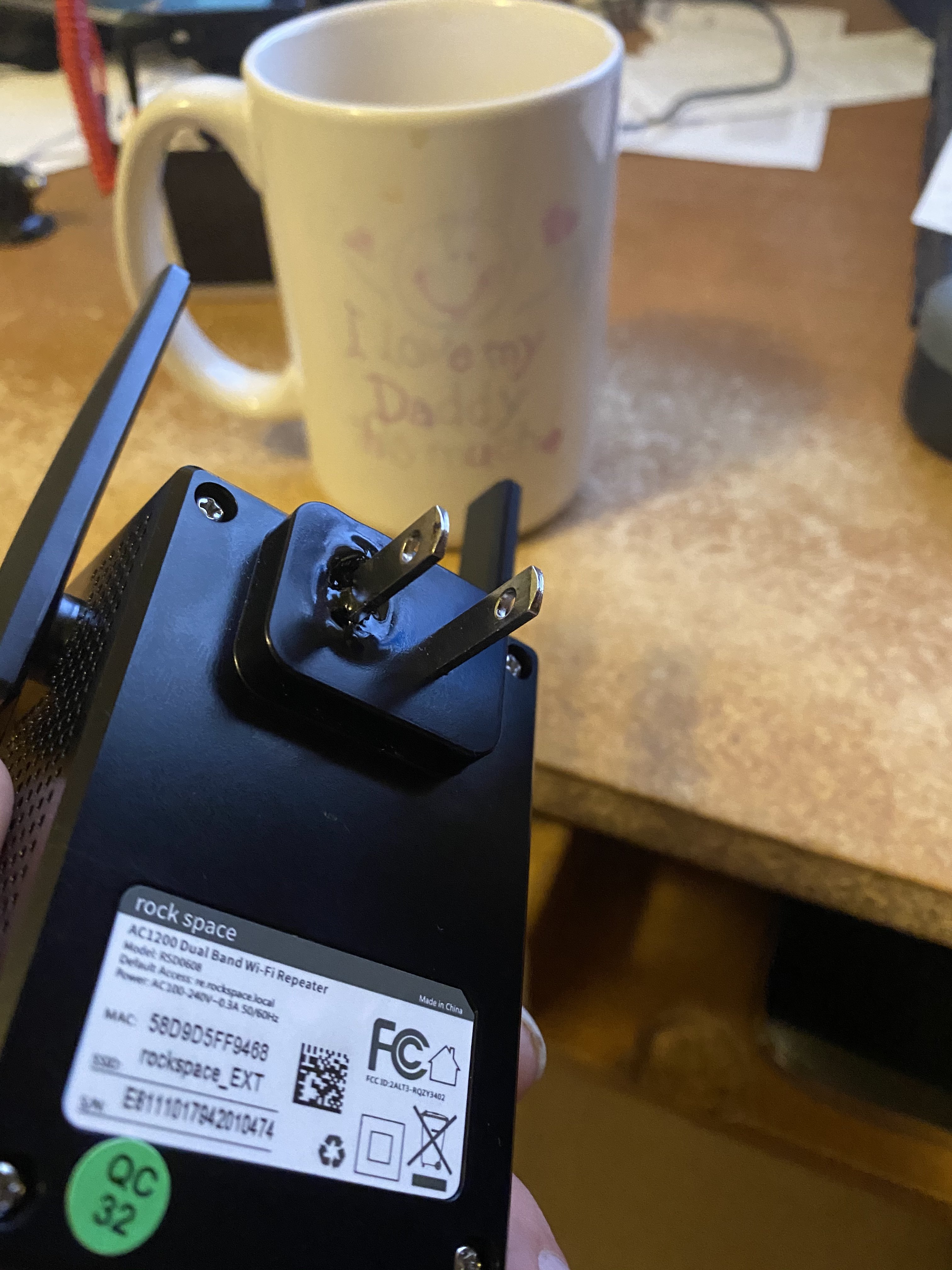

I don't think it was the Wifi extender that caused the plug to fail. I think the plug itself was bad. I had noticed a slight browning coming from the plug about two weeks ago but thought it was caused by my vacuum not being plugged in all the way. I guess not. Thankfully the GFI worked and shut things down. When I went to the shop to figure out why things weren't working, I reset the GFI plug and saw a blue spark shoot out of the bad plug.
You can see in the pic that the Wifi extender got so hot it melted the back of the plug part. I tried plugging it into a working outlet and it no longer works.

Double check the breaker size in comparison to the wire size. My understanding is that everything in a commercial building has to be at least 20 amp which means all the wire must be 12 gauge or thicker.
The best idea would be to have a licensed electrician check out your wiring. I would not depend on labels on the outlets, especially when employees are concerned.
24,051
Redding
All plugs are 20am and also have 50 amp plug for RV or whatever.
I think the issue was the plug was just bad. I thing somewhere something got cracked inside. The breaker never tripped but the GFI did. Im happy it did. My electrician buddy is coming over to look at it.

I just spoke to our electrician since he was here doing some work and he says the most likely cause of that happening is the outlet wasn't make a good connection to the plug. Or in other words, a worn plug.

A lot of newer outlets use compression connections rather than using a screw. Cheaper outlets don't hold the wire very well and can short/break and melt like this one. I've learned my lesson and don't buy the bargain outlets and switches at HD anymore.
Have your electrician buddy check out a few good outlets while he's there.
Or maybe it's just you.
And our electrician says to never use the stab connects. Always use the screw connector.
