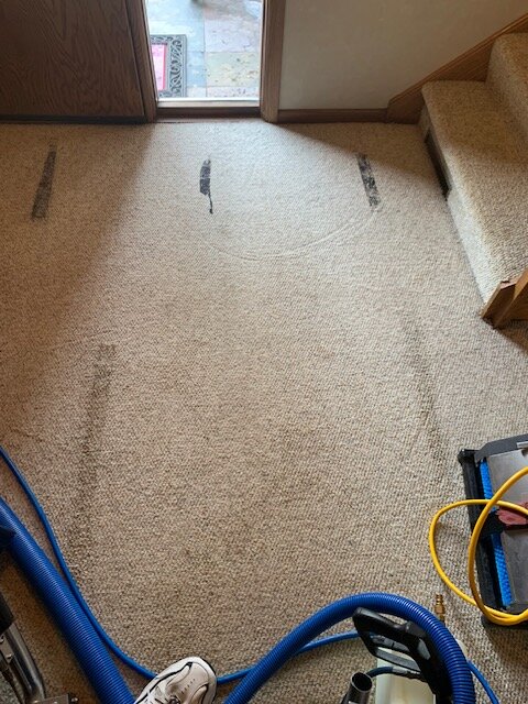

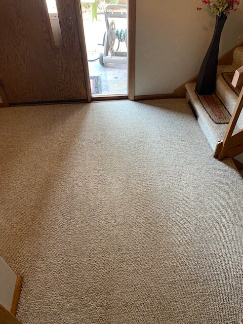

sassyotto
Jun 7, 2013
1,286
Paul
Paul,
Nice Job!!
What chemical?
What process?
this was the entry from the garage. I cleaned the rest of the carpet (including steps which were WET when I took the picture) and started to work on the two strips in front with DeSovAll and ran out. Went to Home Depot and got an adhesive remover for carpet and that worked pretty good. Between DeSovAll, Citrus Force (diluted) and Home Depot Product and a lot of time, got it all out.
Reactions: Kenny Hayes
frank fratto
Jan 27, 2018
209
frank fratto
I think it looks damn GOOD!!!
