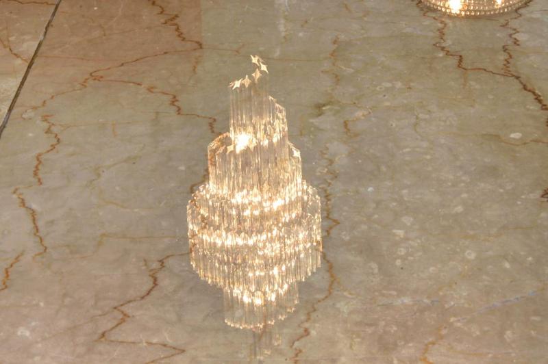

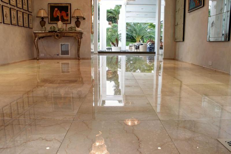

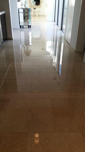

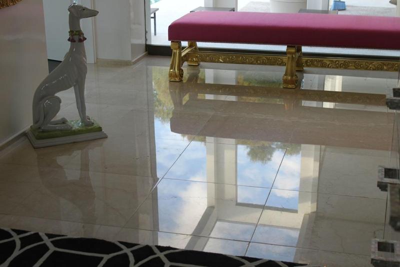

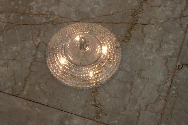

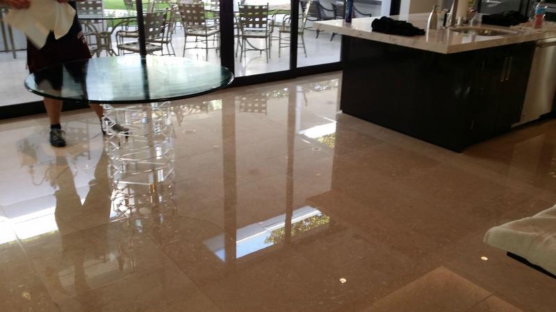

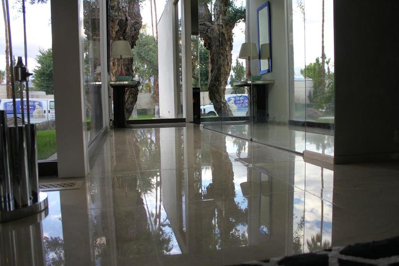

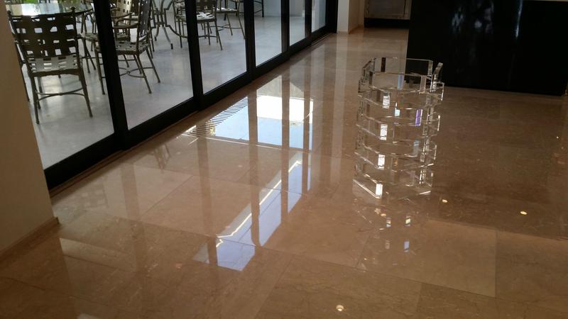

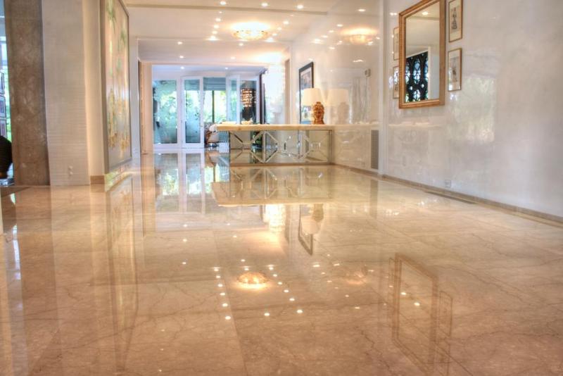

Simple steps. 220,400,800 and 1800 resin diamonds, followed by polishing powder. not really a whole lot to it. I keep seeing these companies promoting their synthetic pads, (which have a place) to replace diamonds. I don't use 50 and 120 grits. Starting at 220 pretty much takes the "danger" out of it. The hardest thing you have to do is make sure you are overlapping correctly.
I will post some more photos when I get around to editing them. The ones that show the reflection of the chandelier have been edited to get the lights to pop, but that clarity is straight from the stone.
