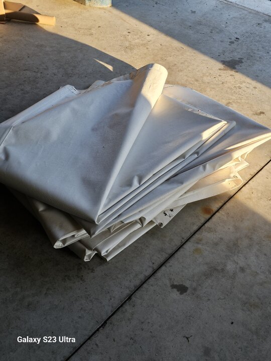

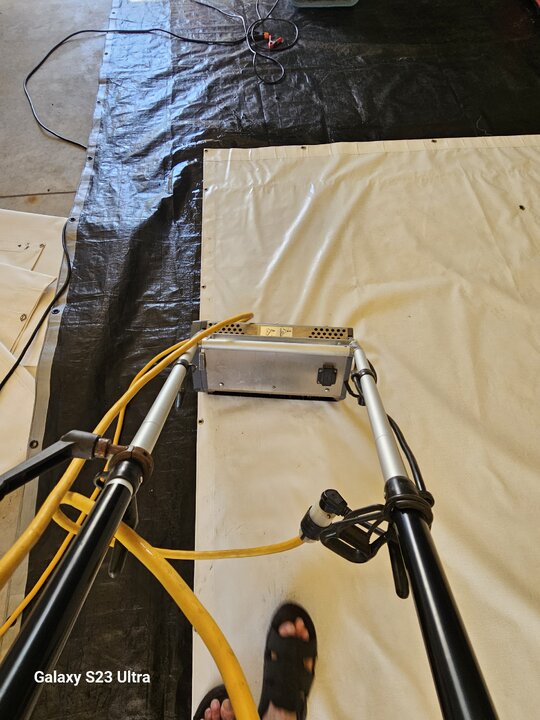

I use the black brushes on these vynil drapes. There are 8 of them that hang inside that deck thats 18x62. 20250506_200449.jpg20250502_155125.jpg

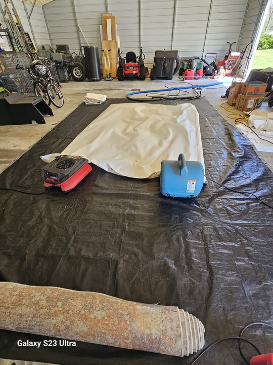

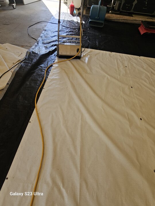

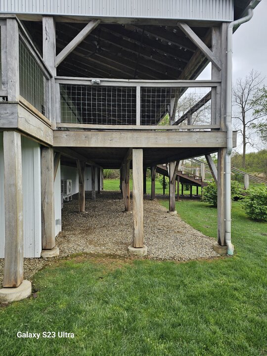

I like the black brushes. I have not found them to be too aggressive on any surface. 20250508_161520.jpg20250508_165127.jpg20250508_165139.jpg
