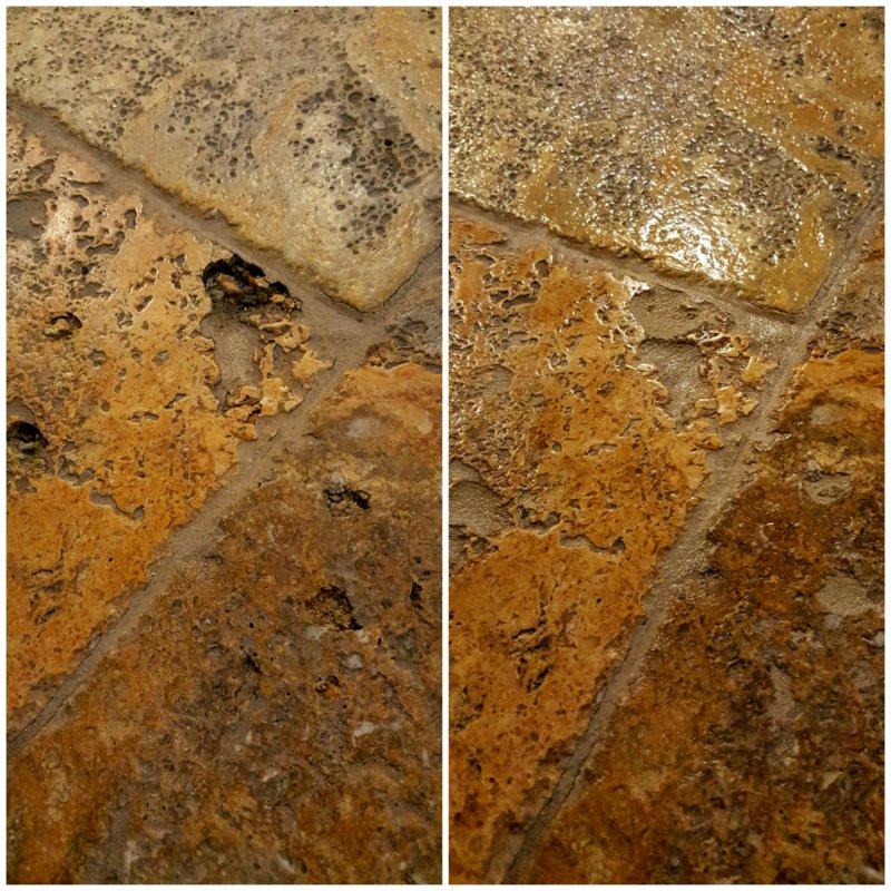

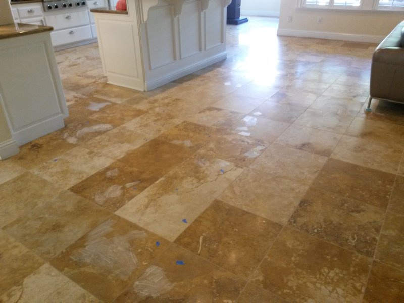

May 11, 2016 #6 GeneMiller Member Joined Mar 24, 2009 Messages 3,547 Name gene miller What did you fill it with, Unsanded grout . I don't do it anymore , I just start to lock up if I'm down to long. Most of the guys here use the expoxy filler now.
May 11, 2016 #7 Mike Pailliotet Administrator Joined Oct 6, 2006 Messages 117,322 Sanded, mixed 50/50 with Acrylic Admix and water
May 11, 2016 #8 B Bee Busy Guest I did this for 4 hours today, it totally sucked, but paid good Last edited by a moderator: May 12, 2016 Reactions: Mike Pailliotet and dgardner
May 12, 2016 #9 jcooper Member Joined Oct 7, 2006 Messages 3,232 Name Jerry Cooper clean image said: please tell me you didn't put a topical on there Click to expand... Why wouldn't you seal travertine? Mikey P said: just wet... Click to expand...
May 13, 2016 #10 Mike Pailliotet Administrator Joined Oct 6, 2006 Messages 117,322 We sealed the floor with a PENETRATIVE last month..
May 14, 2016 #11 Hoody Administrator Joined Oct 24, 2007 Messages 6,470 Name Steven Hoodlebrink Years of Experience 20 You said... Mikey P said: PENETRATIVE Click to expand...
May 14, 2016 #12 clean image Member Joined Oct 5, 2012 Messages 971 Name Carl Maddock Impregnating... Ok Not film forming sealers
May 15, 2016 #14 GeneMiller Member Joined Mar 24, 2009 Messages 3,547 Name gene miller didn't know you could use sanded grout. i always thought it would scratch the finish.
