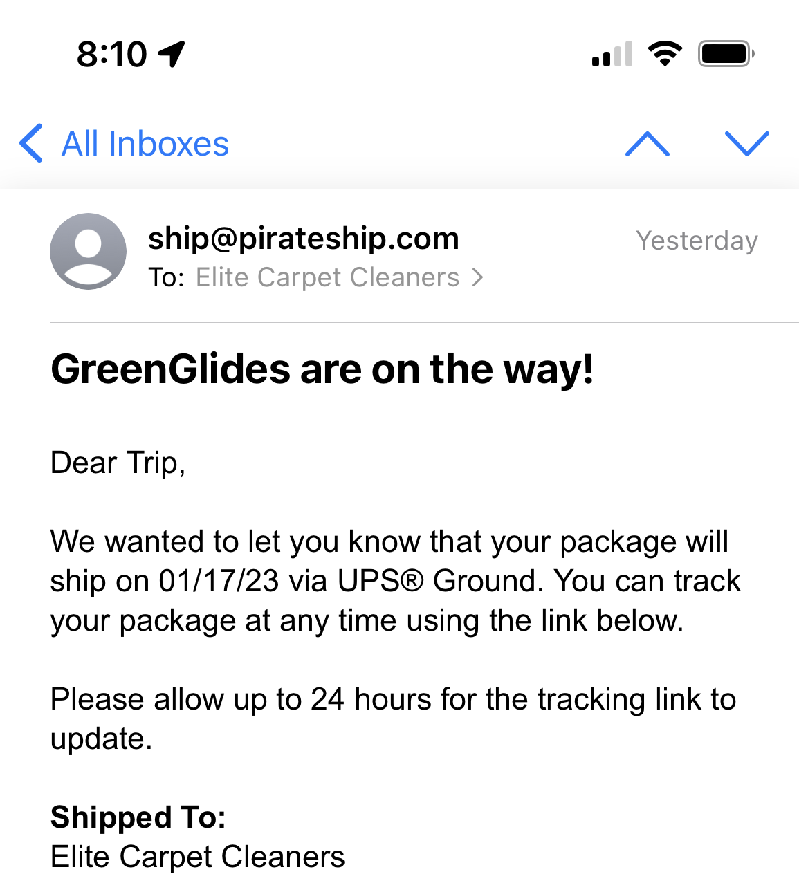

lol...I recall you canceling an order when Olson took his...
No. I canceled my order when he was a ******* dick on the phone. When y’all were selling a product that wasn’t ready to sell.
At the time of order, it didn’t say you’re taking pre-orders. It looked as if the product was ready to be bought and shipped.
117,317
Well, I'm going to close out that invoice otherwise it screws up my QuickBooks. But the offer stands whenever you're ready
Reactions: SamIam
Trip Moses
IMOL
Sep 19, 2018
3,624
Trip Moses
I’ll buy them. I was going to this morning. I just don’t want to get the slot. We talked about the hole and brush. Your the one that brought up old shit.
Reactions: SamIam
117,317
It's all good, I just hate open invoice on QB
Just let me know what you want
