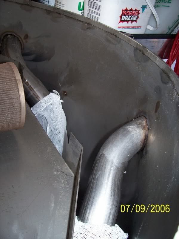

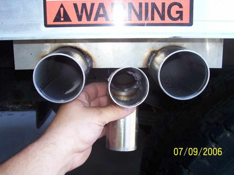

The best thing I ever did. That kit looks really good. AT did a good job on that. I had a local welder do all of mine. I think everything cost about $440, metal and welding. I got a good deal.
I dumped the filter sock in about 10 min. of use.

18,851
Lee Stockwell
The FlowEzy filter(s) at the top look to be pretty loaded up too. Spin them off and clean them from the inside out. Hope there is more than one??
A
adamh
Lee
There is 3 filters and the discoloration you see is the pantyose that I have on the filters. I clean mine everyday.
G
Greenie
panty hose are beautiful, just brush them off with your hand daily.

John Crystal
upgrade
Ian
What did the upgrade parts cost you, in parts and getting them welded in?
Thanks
John
T
The Wizard
All the pieces you see in the above noted pictures including the vacuum manifold cost $692.00 US.
Not sure what it will cost to have them welded on and put in place, I figure the whole project installed should not cost more than $1000.00.
Once it's all done I'll let everyone know.
The Wizard.
18,851
Lee Stockwell
Re: the filter comment
I see the kneehigh cover, but I was speaking of the stuff in the pleats, especially noticed at the ends. If you pressure wash the filter out from the inside it looks like you could blow that out.
We run two 3" ss Flowezy filters on each of our little 47's, so three sounds about right for the bigger blowers. I've seen a bunch of 405's with the fitting reduced to use a 2" filter...bad economics.
